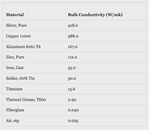

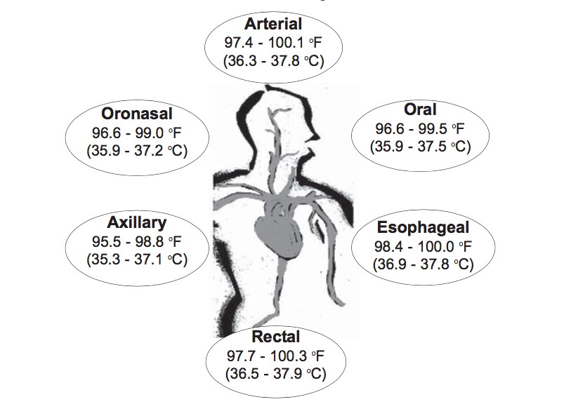

    0 balearicdynamics over 10 years ago
    it seems that I have found the right way for the solution.
    As a matter of fact it will be an integration between the direct-touch sensor actually used by many digital temperature probes, and a comfortable support for direct skin contact continuous temperature measurement. The possible repere points maybe ascillar and oral, plus direct skin contact, expecting different temperature ranges as shown in the image below.
    The design idea is to use a copper terminal joined to the IC sensor put internally to the device and facilitating the thermal conduction with a thermal-conductive paste.
    The only issue I see is that copper is subject to oxidation, but it is one of the better tolerated metals by the human body and as shown in the table below, it has a very good thermal conductivity coefficient.
    The alternative for the terminal supporting the IC is using acrylic plastic material that has also a good conductivity, but some experiments should be done,.
