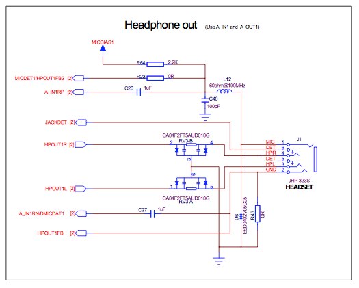

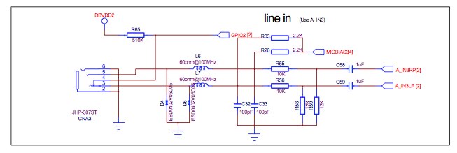

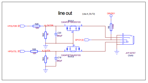

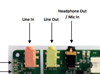

    I'm not so sure the Cirrus card will work for me now. It looks like they combined the mic input and audio output together into one connector. I need both available at once. I've tried looking up documentation for what the header pins are connected to, but I can't find anything (the link to the schematic is a 404). Can anyone help me with this? Thank you!
    Honestly, it looks like they're not using anything close to the full potential of the chip, unless those header pins let me get at it.
