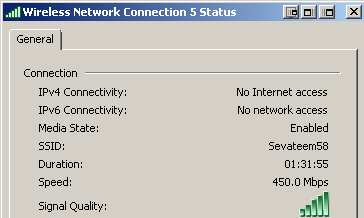

    In case anyone is interested, I have ran a few tests while connected to the AP at 5.8Ghz 802.11n (450Mbps)
    I was able to average 133.125 Mbits/sec with a peak of 144 Mbits/sec with no tuning or tweaking:

    0 Problemchild over 10 years ago in reply to bobalexander
    was the source on the WIFI as well or connected via copper?
    Also are you sure the USB WIFI adaptor is capable of using all that bandwidth offered..
    Personally I think that's very good either way getting a 1/3 of the max available bandwidth in real life!
  • bobalexander
    0 bobalexander over 10 years ago in reply to Problemchild
    The source (Banana Pi) in the WiFi test was connected to the AP (Cisco 2702i in autonomous mode) via GigE copper straight in.
    The WiFi adapter in my laptop is an internal PCI Express Half Mini Card (Intel - Centrino Ultimate-N 6300 AGN).
