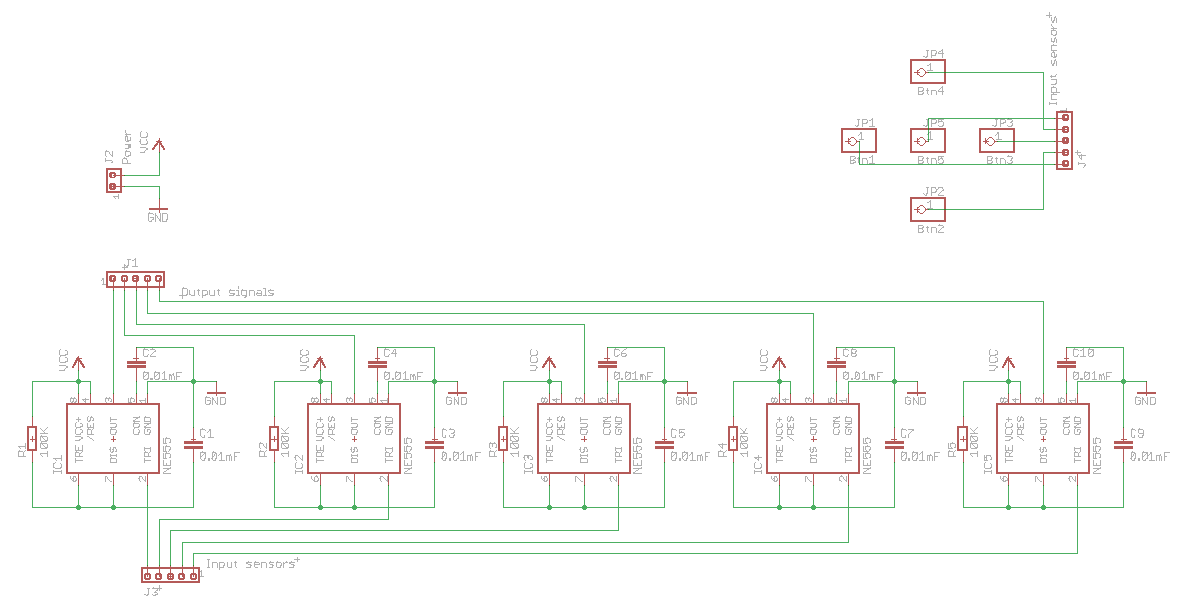

    As the console uses almost vintage joysticks and buttons, I suppose that they has also the need to be managed properly to reach the switching quality needed by the micro controller hardware at the date. To simplify the software on the micro we can send already "cleaned" switch signals with a debouncing bank (also the cost is really very few $) with a circuit like the example image below, done for 5 switches (can be expanded as well)
    Then we should consider that we are working with 30 input switches and the switch detection time is strategic in most of the arcade games. So all the 30 inputs can be read sufficiently fast by a shift-in register (four daisy chained registers can manage up to 32 inputs) so the ChipKit PI as a matter of fact should continuously monitor the four-bytes input status, check if some bit has changed and with some fast AND operations will send the corresponding character to the Raspberry PI. As the communication / parsing protocol on the Raspberry PI receives a CR as the end command it is also possible to send multiple characters if needed to manage simultaneous button press if needed. This is a parameter that can be set at software level.

    Maybe an alternative. But the bare buttons connected to an input are not sufficient in my opinion should be debounced. Then, there are 30 inputs, and I vote again Arduino. Better the PIC 80 MHz More reliable.

    Yeah, either a hardware debounce could be built. It might also be possible to employ some software debounce.
    0 balearicdynamics over 10 years ago in reply to gadget.iom
    Software debounce is almost impossible for two reasons. The first is that you have 30 inputs so you should use a shift-in register and the second is that also when possible, this introduce a huge complexity in the code (AFAIK) that is easier to use something like the schematics I posted in above.
