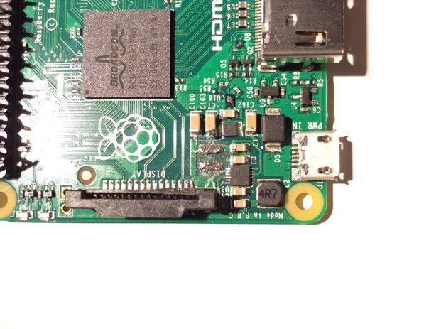

First of all I'm a beginner, so please don't judge me I know I did something bad.
SO, yesterday I was trying to make my raspberry pi 2 B to work with an external battery. I took a lithium polymer battery with 3.7v and 2500mah and I connect it to a booster. At first I was trying to hook it up to the micro usb input on the board and it didn't work. Then I look in youtube and I saw people plugging external batteries into the gpio pins. I joined the positive cable into the the first 5v pin and the negative cord into the first 3.3v pin and vs. Although when I connected the positive cable into the first 5v pin and the negative into the 3.3v pin for the second time with longer time touching them, it sparked and then I saw it left a kind of cut in both gpio pins. Now this morning that I try to power up my raspberry with a normal micro usb cable, I can feel the board getting warm(normal warm) but the led does not turn on.
In the pictures attached, the voltmeter says 4.12 v output but yesterday I adjust it to 5.2v also using the voltmeter but I don't know why it shows 4.12v now... And also in the mark on gpio is the same in the other side (the first 3.3v pin).
Is there anything I can do? Or is it burnout forever?
Thanks in advance.

    It seems both the 1.2 and 1.8V rails are quite ok in your case. However, the 3.3V rail being so low is not good. There are many chips on the board using the 3.3V power rail. If the CPU is getting really hot when powering the board, then it is probably gone. What about the ethernet and USB hub chip? This the one with the SMSC logo onto it. Is this chip getting hot too?
    Other ideas would include to desolder L1, which is the inductor used by the 3.3V regulator. By doing so, you will disconnect the 3.3V rail. If afterwards, the 5V rail is quite normal (the voltmeter readings should show a value close to 5V), then this means the fault is only in the 3.3V rail and it can be in one or more chips using it.
    To definitely know which chips are faulty, you can power the board from USB (having the L1 inductor disconnected, thus the board's 3.3V switching regulator won't interfere) and then connect an external 3.3V power supply (you can connect it at the point where you should have 3.3V) capable of delivering a few amps (at least). Then, all the faulty chips should get very hot.

    0 e14 Contributor over 10 years ago in reply to bbolo1
    Hi!
    ok so at first, I tried to desolder it, and damn it was hard to, so I was scared to touch the others things around it. I ended up by breaking L1 carefully and then I was able to put some rosin core on it to make it easier for me to conduct things up. Can you tell me where am I supposed to join things? like the + and -  of the 3.3v battery.
    I'm going to attache some photos. Would you be able to tell me if I did a good or if I did not x.x
    Thanks!
    The picture got rotated.. image

    Before going any further, just make sure you have a regulated 3.3V supply (have a powerful 3.3V LDO on your battery so it will have enough amps to supply).
    Now, put the "-" to any "GND" point on the board and the +3.3V to the upper part of the capacitor that filters the 3.3V rail (marked in orange).
    Then, power up the board using a USB power adapter. The switching regulators will supply the 1.2V and the 1.8V rails.
    Afterwards, connect your 3.3V power supply and check which chips are getting really hot.
