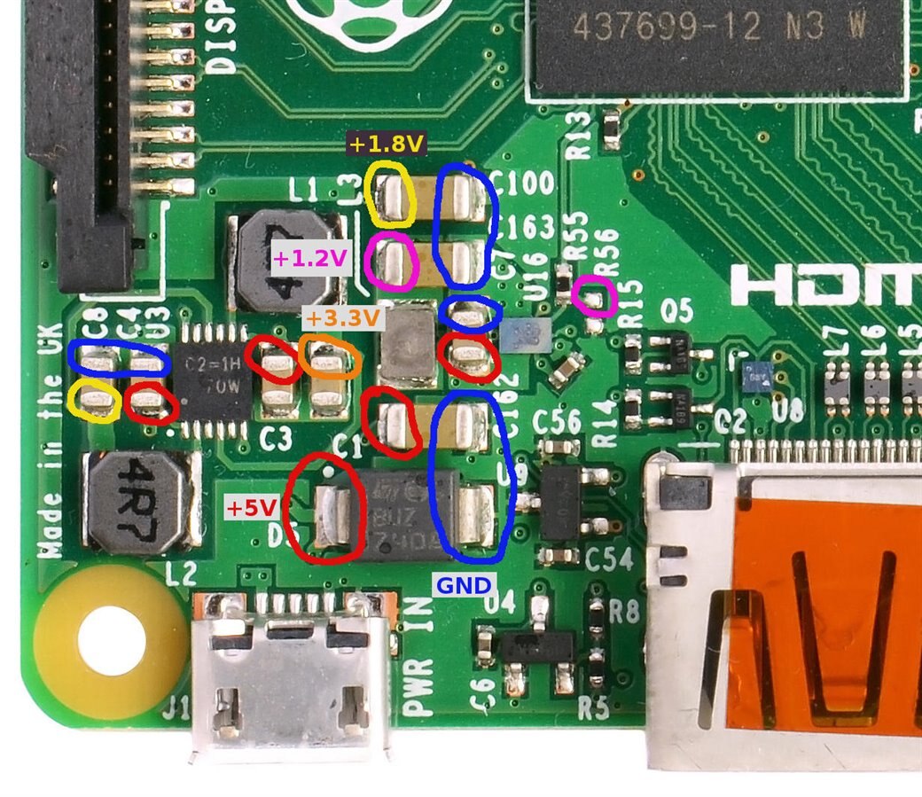

  • bbolo1
    0 bbolo1 over 10 years ago in reply to rew
    I think for Mauricio, this is a good learning experience. Even if the board turns out in the end to be fried, at least he will remain with some valuable learned lessons.
    The bad thing about RPI2 is that the schematic is not available.
    I made some rough sketches over a high res photo of the RPI2 power supply area.
    U3 and the famous U16 (the flash camera shy chip) are switching regulators.
    U3 takes 5V (from the USB receptacle) and provides 3.3V and 1.8V power rails. The camera shy chip (U16) provides the 1.2V power rail.
    And now the debugging part. Before going any further, I want you to know you will need to desolder some parts to be 100% sure the bad parts are removed. Rather than throw away a defective board, it can still provide you some electrical debugging lessons.
    Since both U3 and U16 are buck regulator chips, you might be able to avoid desoldering them.
    Take a look at the attached picture and make some measurements while powering the board from an USB adapter.
    1. Check the voltage on the point where you should have 3.3V
    2. do the same for the point where you should have 1.8V and 1.2V
    Please come back and tell what voltages did you measured. Based on your findings, the next steps will probably involve desoldering a few parts from the board.

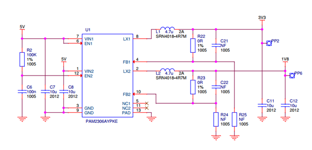

    0 shabaz over 10 years ago in reply to bbolo1
    Wow - great detective work!
    Just to add to that, based on your photo, it looks like the U3 device is PAM2306A, because on a hunch I checked the Pi Compute Module schematic (which is published) and the pins on U3 appear to match that schematic. So it is probably a near-identical schematic for that portion (extract of the Pi CM schematic under fair use):
    Interesting how the part in your photo is clearly not marked as that device though (the datasheet specifically indicates the package marking). However, it is highly likely to be the same part, or one in the same family.
    I think it is important for use to know this area of the circuit, because so many questions come up related to this topic in some way.
    Just goes to show how important schematics are for those who want to explore more.
  • bbolo1
    0 bbolo1 over 10 years ago in reply to shabaz
    Thank you! I think you did a great job too. image I wasn't able to find the mysterious U3, dual regulator chip.
    BTW, I used the RPI2 hi res photo available on wikipedia. I don't think I would be able to take a better picture image
    Now, having your input, I think we should have at least some good knowledge about RPI2's power supply.
    Since I was assuming the U3 is a dual buck regulator and if in Mauricio's case, the FETs are broken in this chip, he might get along with only desoldering the L1 and L2 inductors (assuming the U16 - camera shy chip is not broken). If U16 is broken as well, then desoldering L3 as well would at least isolate the CPU's power rails from the regulators.
    If the 3 power rails (3.3, 1.8 and 1.2V) are not drawing excessive amounts of current, then there is still hope.

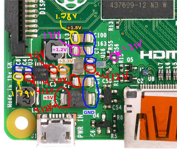

    0 e14 Contributor over 10 years ago in reply to bbolo1
    Hi!
    Sorry for late responding, I was doing a final exam. x.x Anyways mine is different when it comes to the voltages for the 5v.
    And by the way, when I plugged the raspberry pi to my computer it showed me a message saying the usb is taking a lot of power; I don't know if it's an important information.
    This are my measurements:
    Thank you for taking your time to teach me image
    0 shabaz over 10 years ago in reply to e14 Contributor
    Hi Maurico,
    Did you measure the orange location? That one is very
    Important to measure. There is a good chance it may be higher than the expected 3.3V : ( which would be bad news. Anyway, it needs checking.
    0 e14 Contributor over 10 years ago in reply to shabaz
    Thank you for the reminder! It's at 0.40v.
