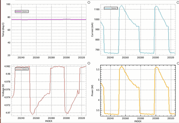

    It was interesting to see the Pi 3's behaviour where it seemed to toggle between a few (seemed like 2 or 3)
    values under certain conditions to try to and cool off (see graphs below). Whereas some Intel chips drop and then ramp up. Probably there are patents in some of these implemented strategies I guess.

    Anyway, for compute module Pål, (rew I had to go into HTML mode to do that with å, couldn't find another way ),  make sure your software engineers are aware that throttling could occur if you determine that the temperature and amount of processing could result in this. They will need to test the application under such speed conditions (more relevant for the compute module than an app for a PC or tablet/mobile phone).
