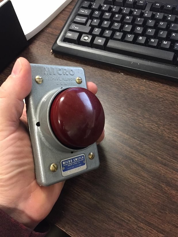

    I found my "micro" power switch....
    • Reject Answer
  • luislabmo
    0 luislabmo over 9 years ago in reply to rsc
    Ha, you got very tiny hands and keyboard! image
