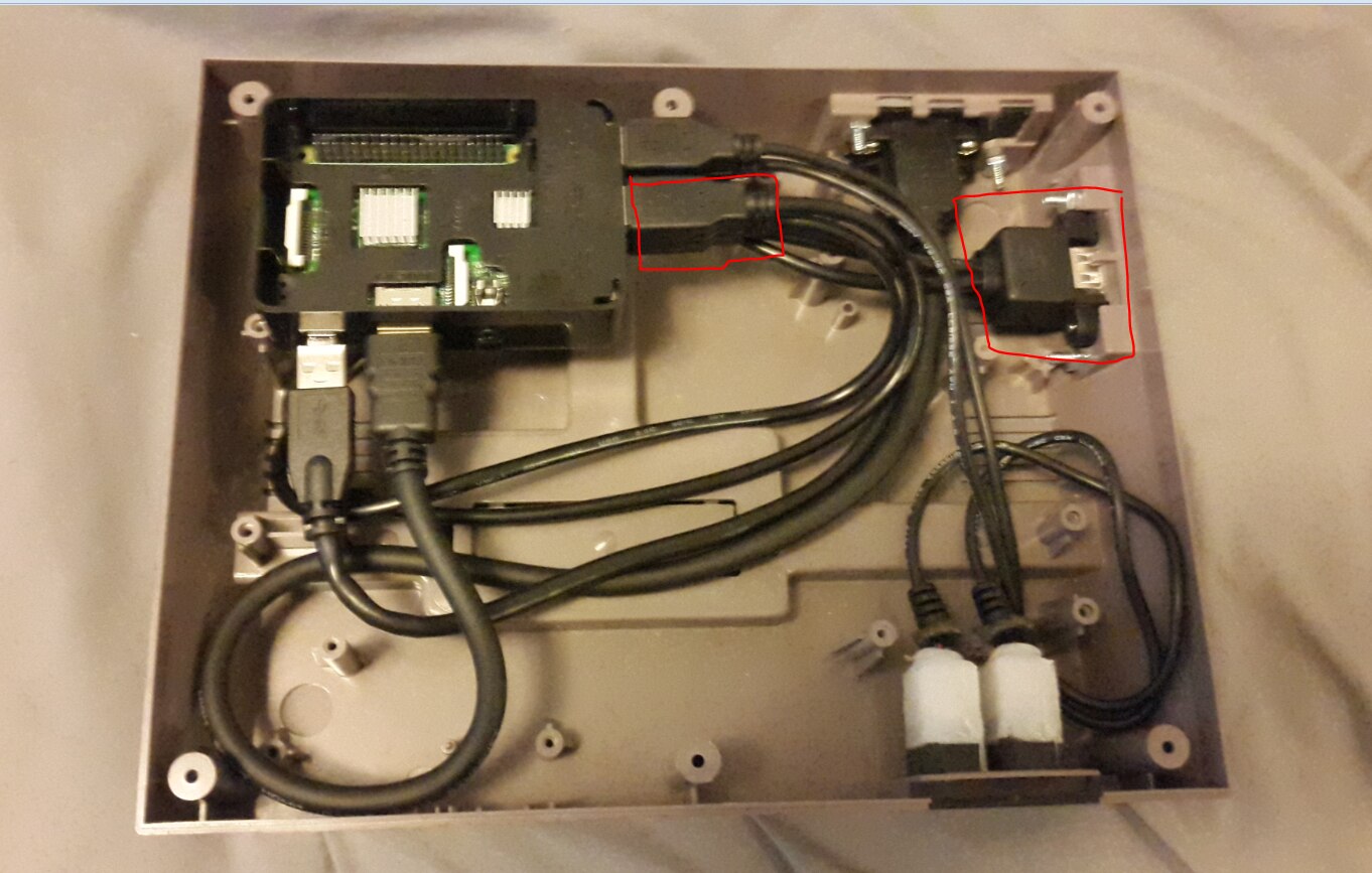

So i am doing the nespi project and have found that i need power to a usb hub and power to the pi. I only have installed one usb 3.0 port for power to come into the nes case. If i get this power supply --> https://www.amazon.com/Adapter-Portable ... wer+supply
Can i take two usb cables from ^^^this power supply from a usb splitter into a single usb cable then split it back out into two usb connections. Then have one end go to the pi and the other end go to the usb hub to power both devices.
Another possibility i have thought of is trying to bring more amps to the usb hub but i do not know it it can handle more power in and if that would allow it to output more power per port.
I would also greatly appreciate any other ideas on how to get power to both devices with only using one usb port to get power into the case.
Attached is the setup before the powered usb hub was added in to power the 4 controllers separate from the pi's power. And the back port is the single usb 3.0 port i have to bring power into the case.

    Thanks for that info. Hmm so i may have to try another route with getting a second set of power into to the case. I have another idea the i could try if it works....
    So here is my other idea(long shot). Coming from my usb power source have a usb to 3.5mm adapter then from the 3.5mm cable back out to a micro usb cable to power the hub then use the normal usb cable that i have been tring to use use all along to power the pi?
    Can 3.5mm carry 5v?

    Im in missouri and i have found a 3.5mm panel jack to male 3.5 connector so no soldering would be needed. Its like a headphone connection vs a barrel connection. So i would have a usb to 3.5mm adapter to this panel jack >> https://www.amazon.com/gp/product/B00QHF3WY8/ref=oh_aui_detailpage_o09_s00?ie=UTF8&psc=1  Then from this panel jack to a 3.5mm to micro usb adapter to the pi.

    From the back of the nes it is a panel mount female to male USB 3.0 cable(i did this so it could be installed to the nes as a power port more or less). Also at the end of this cable it is a microusb adapter going into the pi.

    I do have a good update. I have found that i am getting enough power to the pi with the single usb 3.0 port and cable with the 5v 3a power supply. I found the issue was related to the dual port usb i had running controller 3 and 4. Adding a splitter to the dual usb port with the controllers caused the pi not to boot. Running the pi off the usb hub caused low power to the pi. I then was still having issues with controllers 3 and 4 going in to the dual port usb. So i decided to bypass them and boom everything was working with no issues.
    It seems that the dual port usb some how scrambles the power and data between the ports which messed up the controllers powering on/working correctly.
    On a side note the wires that i used for carrying th power in are both 20awg usb 3.0 cables so shouldn't have any issues with those.
    The two red squares is where my issues occurred from once eliminated everything seems to be working ok again.
