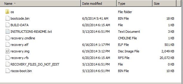

    0 tcoder over 10 years ago in reply to gdstew
    I pulled the SD card and looked at it.  There is no file called "cmdline.txt" on the disk.  Here is the contents of the SD card:

  • gdstew
    0 gdstew over 10 years ago in reply to tcoder
    Not sure what OS you are using other than it is not Raspbian. I see the riscos-boot.bin file but the fact that you used raspi-config which is I believe a BASH
    script program to fix it has gotten me really confused.
    Good to see that you got it working !
  • tcoder
    Actually, it's what came with the Pi I got from Element 14 along with the preconfigured SD card. I had two SD cards and they were both the same.
