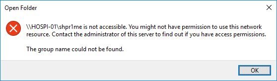

Now the fun!
When I try to create a mapping from my PC to the Pi, I get "Access Denied" no matter what user I use, even pi.
I ran the diagnostics from my PC and I can find the server, (although it does not show up in Networks). I even confirm the share exists. I just can't map to it.
I try to change the ownership of the mounts from root using the chmod command, but I get "Operation is not allowed". (Yes with sudo.)
I can't seem to allow any user to use these mounts remotely. I can only use them from the Pi! This is not a file server, but just a workstation. I can't find a way to associate MYWKGRP with these mounts with the right permissions.
I've seen a way to explicitly state a user and passwaord in the fstab file, but that would not syncronise with any change of password with the PC. (Not to mention the horrible hole in security!)
Can anyone tell me what I'm missing? Thanks for reading this far.

    Now I try to map from Windows 10.
    Network still doesn't show the Pi. However, I can ping either the IP or the HostName from my PC.
    When I use \\HostName\SHARENAME
    where SHARENAME is the section name in smb.conf, I can 'browse' and see all the shares.
    However, providing the credentials of my new user I get the same Access Denied message.
    Providing the credentials of the user pi I get the message 'The user name or password is incorrect'.
    Obviously I rechecked the passwords by logging in and out with both the user pi and my new user. Both worked.
    I seem to be creeping forward, but as you can imagine, this is very frustrating. There seems to be no central admin tool like there was in Novel. I'm sure I'm at the point where this behaviour is so unlikely that a solution is far from obvious. As I'm exhibiting more experience than the average newbie, I don't know if the assumption will be that I've done everything right, so the response will be, "Well, that's a poser!". I'm willing to check every step, again. But I'm currently out of ideas on where to look. Everything seems fine to me, except that it doesn't work. Thanks for reading this far.

    I am only using Windows 10. The second link has lead me on a trail to use make amendments to my smb.conf and the pdbedit utility. It turns out that I added the pi user to samba, but not the new user. D'oh!
    Not quite there yet, as I'm still getting an error message, all be it a different one. However, I did manage to map to the Pi, but not with one of my shares! I just have to figure out where it connects to and why, then I might make some progress. It's taken me all day, so I've not even begun on Sean's help yet.
    I'll keep you both posted on my progress and the new lines in smb.conf, when it's a bit more stable. Thanks guys so far.

    Now to what happens:
    I've managed to create a share called MYUSER which maps to the home directory of the user I log in as. Don't ask me how! I've chmod the permissions on the home directory to be rwxrwxrwx. As you can see above in the [homes] section , I've also changed the masks to 0775. This allows me to map to my 16Gb mSD card home directory. However, I still can't map to my shares. I get a different error message now. :
    I'm still thinking this is a permissions issue, but I've given all the permissions I can think of.
    The opencanary app suggested by sean looks terrifying. I'm on the Internet all the time, and having a completely open Pi is not what I want to do. I know Unix viruses are far less common, but hackers do things for 'fun'. Of course, they are never 'fun' for the poor victim. I just don't want to line myself up to be one.
    Is there a permissions editor to manage the whole set from O/S through samba to files and directories? This sure would make my life a lot easier! So, limiting the advise to the permission issues on the Pi, what do you suggest? What's my checklist? Thank you for reading this far.
