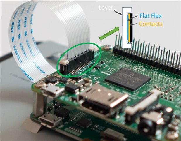

I recently got my first Pi along with a touchscreen, and camera. I'm going to be using it to connect my 3d printer to my network and view the video feed. I successfully got the print server image loaded and it worked great. I went to add the touchscreen and camera and I get nothing. I can connect the HDMI and view the desktop, but the screen and camera are not initialized. I have run the update and upgrade commands, tried different power supplies and sources, different ribbon cables, dis connected and reconnected all of the ribbon cables that came pre-attached, even loaded a new micro SD card with the stretch image... still nothing. I can't find anything else online that might help, so here I am.

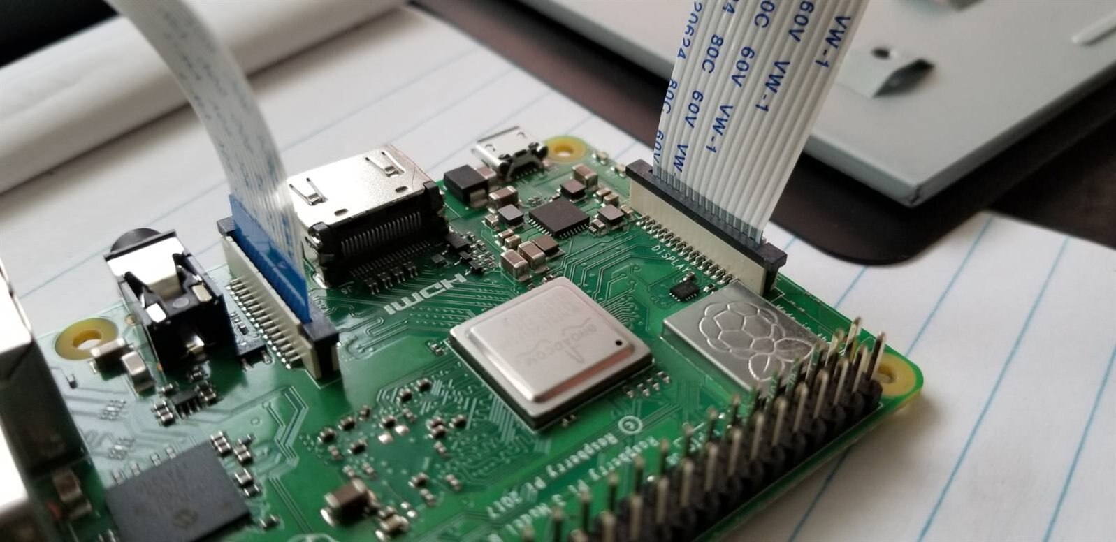

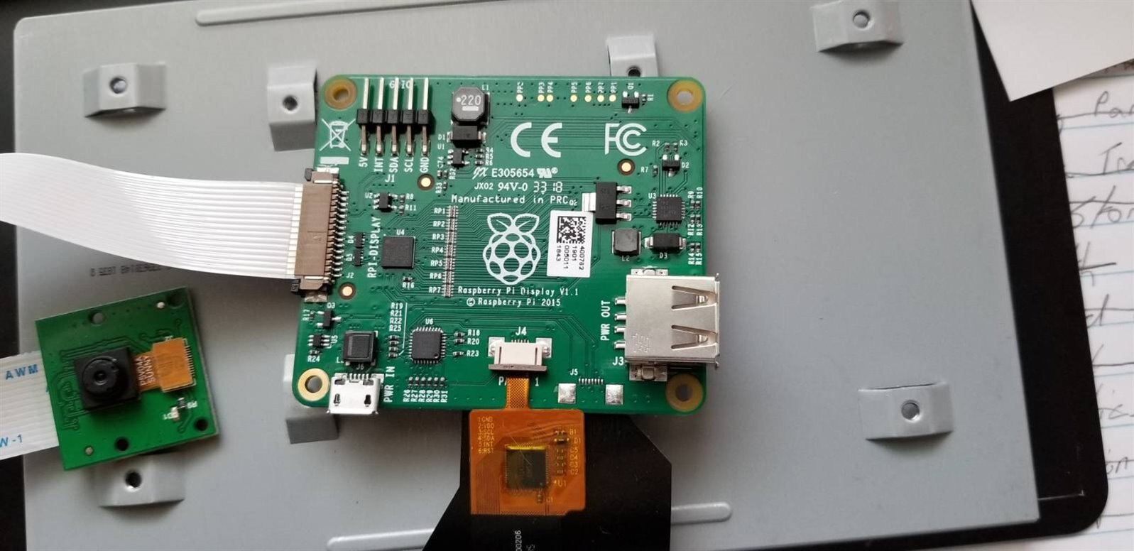

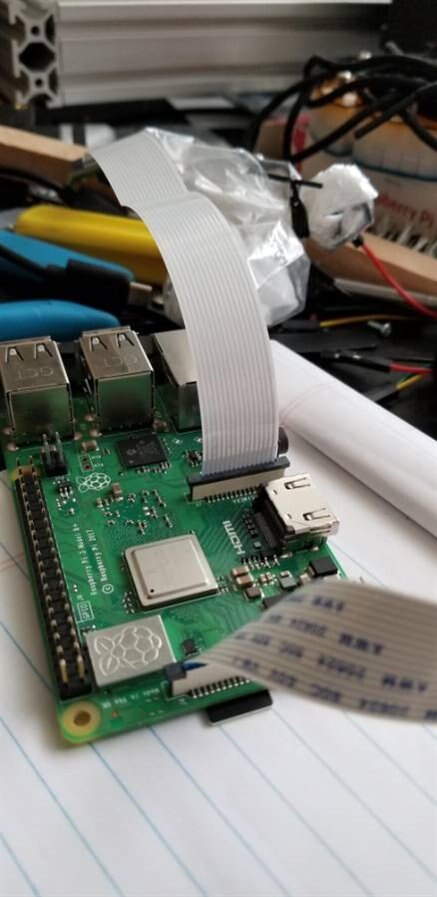

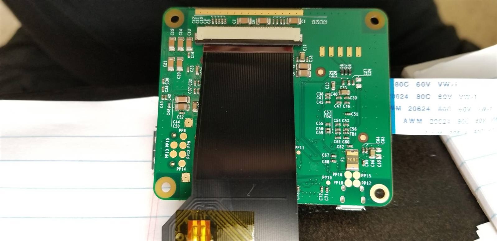

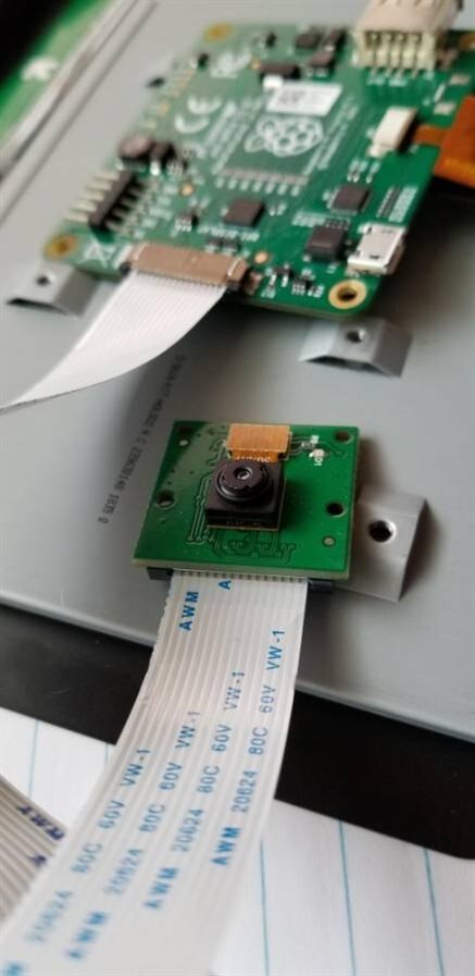

    Ok, took a few so here ya go.
    • Reject Answer
    0 shabaz over 7 years ago in reply to kcontreras41483
    Hi Kenny,
    I think I see the problem, but I don't have an easy solution.

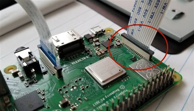

    If you look at the photos at Raspberry Pi 7” Capacitive Touch Display: Assembly and Enclosure  you'll see that the connectors have a lever, and the spring contacts mate on the other side.
    Notice that the Lever portion is facing away from the Pi. The contacts are facing toward the Pi.
    Now, if you compare with your Pi in the photo below, you can see that the lever is facing toward the pi! Unless I'm mistaken, that means the contacts are on the wrong side. The way you've got the flat flex inserted, I believe no pins are making contact because the contacts on the Pi are on the other side:
    In fact both your connectors on the Pi look to be the wrong way around. I've checked four Pi's here, and none of them match your photo. Also, you can't just rotate the flat flex, because then the pins will be back-to-front when connected to the display board. An option could be to use a different flat flex which has the contacts exposed on the other side for just that Pi end. In other words, a flat flex that isn't rotated, but just translates the pins to be exposed on the other side. Such flat flex does exist, but yours isn't that type.
    There was someone else who had the same issue a few months back, but they didn't report back what their resolution was. Basically, the Pi appears to have had its connectors inserted the wrong way around, so you should be able to return it under warranty from wherever you purchased.

    This now makes complete sense why I didn't get any results by just flipping the cable. I have some thoughts, but unsure. I may try to find the correct cables if modding the current ones fail.
