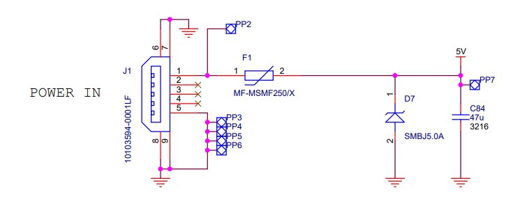

    0 luislabmo over 7 years ago in reply to bjurg
    See Ralph's response, voltage should be measured on the Raspberry Pi to measure more accurately what is the "real" voltage that is getting into the device, there is a voltage drop (or loss) caused mostly by the length of the wire (between other different factors). The Raspberry Pi provides some test pads for this kind of measurements in your case is PP2 -see diagram below and a picture where is located.
    The GPIO is located after the Circuit protection F1 and is a good place measure the voltage too.
    The specs usually target a higher voltage within the specs (5.1V in this case) to compensate easier for the voltage dropped. The RPi 3B+ is power hungry and choosing the right USB Power supply for a project may be difficult at times, one easy way to mitigate this kind of issue is to take a regulated 5V power supply and connect it directly to the 5V GPIO or maybe you can try to put PP2 to good use image
