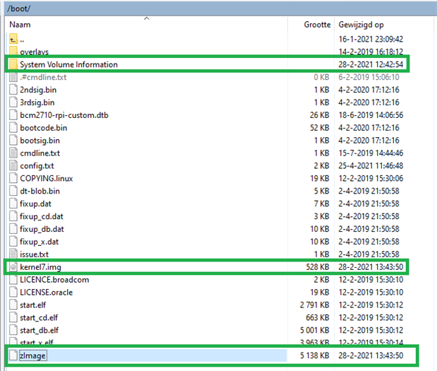

    0 Jan Cumps over 5 years ago in reply to rok_jarc
    I wanted to double-check if I am really using the 20210228 image.
    It's confirmed:
