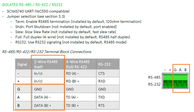

By default, the serial output is configured as RS-485 half-duplex, terminated. This is how I'm going to test it.
image source: SmartEdge Industrial IoT Gateway User Guide
The pins to use are GND, A- and B+.
image source: SmartEdge Industrial IoT Gateway User Guide - click for a sharp image

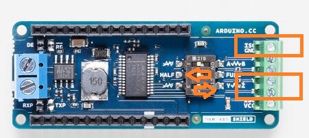

Arduino MRK 485 Shield
This one is by default full duplex. Move the middle switch left to switch to half duplex.
image source: https://store.arduino.cc/arduino-mkr-485-shield

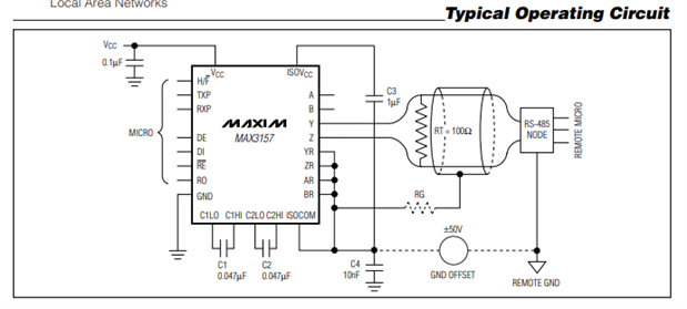

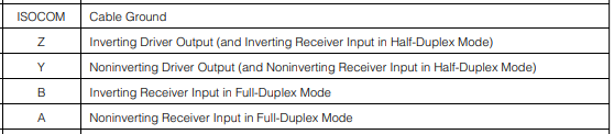

The pins to use are GND, Y and Z (on the MKR 485, these are the data pins in half duplex mode)
images source: https://datasheets.maximintegrated.com/en/ds/MAX3157.pdf
While the SmartEdge's bus is isolated, the one on the Arduino isn't. It does not matter for this application.

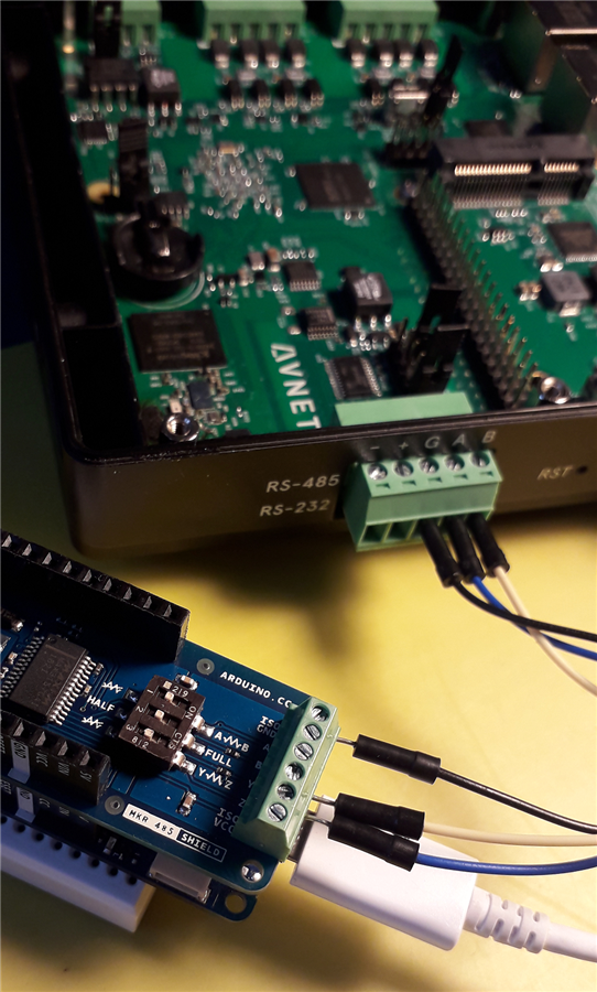

Connection
  • GND to GND,
  • SmartEdge A to Arduino Z,
  • SmartEdge B to Arduino Y.
Twist the two data lines.
I've used an Arduino MKR WIFI 1010

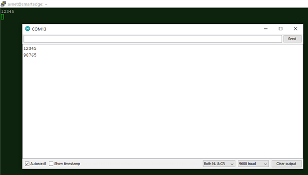

I loaded the RS485Passthrough example. The opened the Serial Monitor at 9600 baud.
In the image below you see the results, after typing 12345 in the Arduino monitor and 98765 in the SmartEdge terminal.
