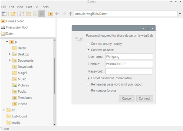

Hello community,
I am having an impossible time trying to permanently connect my NAS to the RPi.
The RPi can see and connect to the NAS through the 'FileManager' menu Go>Network,like this:
Trying to use 'sudo mount' or adding an entry to the /etc/fstab file does not work for me.
Examples:
pi@raspberrypi:~ $ sudo mount //192.168.2.21/ls-wsgl5ab/Daten /home/pi/Daten/ -o user=Wolfgang,password=xxxxxx
mount error(112): Host is down
Entry in fstab:
//192.168.2.21/LS-WSGL5AB/Daten /mnt/RPiNAS cifsusername=Wolfgang,password=xxxxx   0  0
I have looked at a lot of forums and pages, they all say that it should work that way.
So I am guessing that I am missing something else.
What I don't understand, that one part does see the NAS, the other just does not want to cooperate. Welcome to Linux, I know.image
Did anybody have similar issues or a solution?

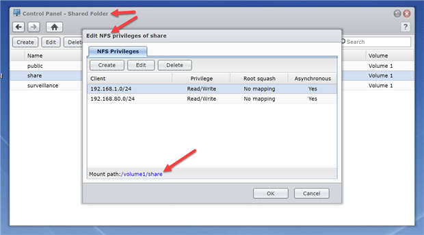

    Hi Wolfgang,
    I don't know the answer, but I know how you can move the scenario to something which may have more success:
    Set up your NAS for NFS file share instead. There should be an option somewhere to configure shared folders, and you can then select NFS.
    Then, you can type (as root user) something like:
    mkdir /mnt/share
    mount -t nfs ipaddr_of_nas:/volume/share /mnt/share -v
    where /volume/share can be replaced by the name configured or supplied by the NAS. The '-v' will help you troubleshoot if this doesn't function.

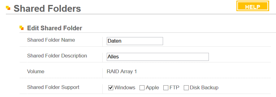

    Hello shabaz,
    This is a very good lead.
    My NAS is an older model (still using IDE drives image) and it seems like it does not support NFS file share. Here are the setup options. I might be SOL for this one.
    Here is the answer to the mount command:

    sudo mount -t cifs //192.168.2.21/Daten /mnt/RPiNAS -o username=Wolfgang,password=*********,vers=1.0
    I This command worked and the issue was from the beginning that I referenced my NAS as //192.168.2.21/LS-WSGL5AB/Daten, when the correct form was //192.168.2.21/Daten .
    Who knew...
    I am sure the -t cifs option also helped, not sure if I want to play around with it.
    Now I just have to enter this into the fstab and everything is perfect. Famous last words....
