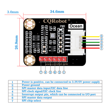

Hello! I've been working with a Rasberry Pi zero for the past couple weeks, following a tutorial to interface with a Barometer sensor (the BMP 085,) and I've ran into a bit of a snag.
The sensor works, everything works electrically, I'm sure, that's more my background, but I'm not sure the code is set up right, or if the Pi can even tell something is connected.

    From the photo it seems to be a BMP388 Barometric Pressure Sensor not a BMP 085
    Use another library like https://github.com/adafruit/Adafruit_CircuitPython_BMP3XX

    0 cagan over 5 years ago in reply to javagoza
    Alright, I'll try this!
    Also, to reply to Shabaz, yes, that's a ground connection. The sensor did not appear to be getting power before I made that connection, I don't have anymore pins I can solder to the board, it's temporary until I can rectify that.

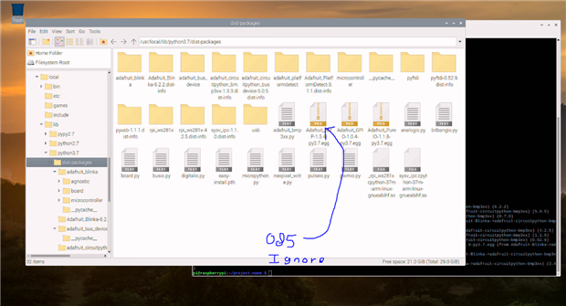

  • cagan
    0 cagan over 5 years ago in reply to shabaz
    I soldered it before trying that new library that Enrigue sent me, the git page said it came with example code, but I can't find, I'm certain I've installed the library as it's right where the BMP085 library is when I installed it.
    I'll show it here:
