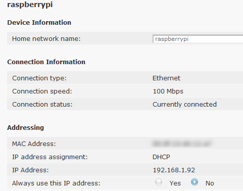

    You can check this, by logging onto your router:
    You should see this on some BT home hubs:
    Notice that there are two 'raspberrypi' "connections", where one is at status "Not connected" and the other is "Connected". The former refers to the wired Ethernet connection (which is disconnected) and the latter refers to the wireless connection. Yours may be on the right side (I have a separate wireless access point).
    Then, it should be possible to get some more detail with the router:
    The above shows the IP address that the router has given to the RPI. You can use that address to connect to the RPI. If you're using a monitor and keyboard then you don't need the above information, and you can obtain it directly from the RPI using:

    On line 17, you can see the IP address.
