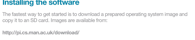

Hi,
I bougth a Raspberry Pi board and played a little with it. I then bougth a PiFace Digital. It sits nice on top of the Pi board,but I need some software drivers in order to use the PiFace Digital board. How do I get the necesserary software into the SD?  I have not got a network connection to it. I guess that I have to add a software module to the SD by downloading it with my PC.
But what is  this module called and where can I find it?

    Hi,
    there is a link to a prepared OS image containing the necessary software in the PiFace "Getting Started Guide". It's on page 1.
    Might be the easiest solution if you do not have any networking capabilities on your pi.

  • fvan
    0 fvan over 11 years ago in reply to ake09
    The standard NOOBS or other images will most likely not support the PiFace by default.
    As stated in the documentation linked earlier, there are two ways of getting th ePiFace to work:
    * use a prepared image which you can write to your SD card (using "dd" in Linux/Mac or "Win 32 disk imager" in Windows). See http://www.raspberrypi.org/wp-content/uploads/2012/04/quick-start-guide-v2_1.pdf on how to prepare your SD card.
    * using network connectivity of the pi, download the necessary packages by following the steps in the "piface get started guide": http://www.element14.com/community/docs/DOC-53057/l/piface-get-started-guide
    Frederick
