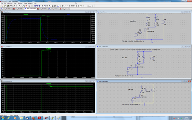

  • michaelkellett
    0 michaelkellett over 12 years ago in reply to D_Hersey
    Don, experience and simulation show that the 1N4001 is more robust and works BETTER than a 1N4148. Other diodes may work better than either but fast or fancy ones will cost more. Using a passive RC network works fine and does not result in ringing of the load current.
    I've attached a rather huge screenshot of the three options simulated in LTSpice.
    The netlist for the RC simulation follows:
    * C:\Docs\Rabbits\relay_zobel.asc
    L1 N001 N002 .47
    R1 N002 N004 288
    V1 N001 0 12
    M1 N004 N006 0 0 NDC7002N
    V2 N005 0 PULSE(0 5 1m 50n 50n 20m 40m 1)
    R3 N006 N005 1k
    R2 N003 N004 288
    C1 N001 N003 4.7µf
    .model NMOS NMOS
    .model PMOS PMOS
    .lib C:\Program Files (x86)\LTC\LTspiceIV\lib\cmp\standard.mos
    .tran 50m
    .backanno
    .end
    The relay is an OMRON G5V-2 type, 12V coil, 288R, 0.47H off, 0.74H on. The simulation makes no attempt to model the effect of the armature moving whe the relay releases.
    In case it's not clear from the picture the 1N4001 ciruit rings for about 0.2mS at about 29kHz, the IN4148 for about 0.5mS at 42kHz and the initial amplitude of the ringing is about twice as large for the 1N4148. In either case the frequency and amplitudes are so low that there would not normally be any EMC issues.
    The passive network works better with no HF ringing at all.
    If you have any other data, measured or simulated, to suggest otherwise, I would be interested to see it.
