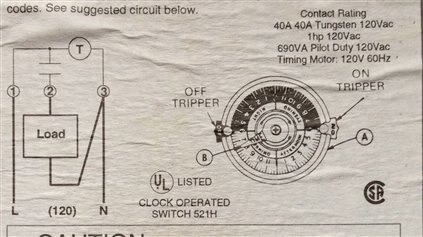

    0 vd0gg1t over 12 years ago
    ok, as promised here are the pics. This inside an unheated barn. (weatherproof but extreme temperatures may be a factor)
    Note: Switch is for pool light in deep end.
    Complete Setup                                                  Timer                                                       Schematic
    Intention: Replace "wheel" with raspberry Pi, an LCD display (for standalone operation), relay(?), and wifi. WiFi would allow the relay to be controlled remotely from a smartphone app.
    I can take further pictures for more specific detail if needed. (example, behind the timer wheel or more focus on tripping mechanism)

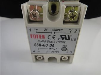

    first BIG issue is the load your switching (The diagram indicates a 40A switch is currently used, I would not suggest underrating the replacement as the startup currents will be quite excessive even if the normal running will probably be under 15-30A, most relay boards from E-Bay are rated around 5A
    A solid state relay will allow easy interfacing, Full isolation and easy mounting see this as an example Solid State Relay SSR 60Da 60A 3 32VDC 24 380VAC | eBay (I selected one that was over rated for safety reasons, You still should have a circuit breaker of course which I assume is elsewhere as it is not visible in your pictures. It can be driven from anything that can power an LED.

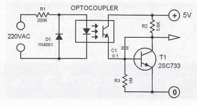

    detecting the motor running is a little trickier, you could assume it is on based on the fact your controlling the relay or you can use a circuit like this
    it could drive an interrupt or you could simply put a diode and rc network to smooth out the output to a logic level and simply have a low high signal. either way isolated and safe.(Adjust R1 to suit 110V if needed)

    btw, a smaller powered solid state relay could also be used to control the pool light you mention.

    Sorry for the confusion. The circuit breaker is wired in the house. It is marked as 20 amps going to the pool but does take two punchouts. So is that 20 amps or 2x20 amps = 40? I have always gone by what is marked. (I might be overthinking this part. Also, I have manually flipped off this the circuit for this project.)
