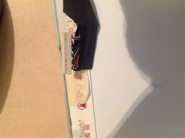

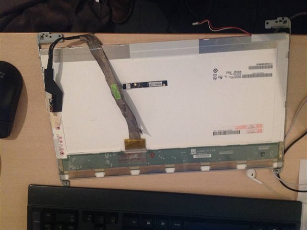

    In most cases the answer would be no. It would be rare to find a Laptop lcd screen with the proper inputs. There may be a chance that you couldn't connect it even with extra parts. But as with everything, the answer is "It depends", we would have to know the exact LCD screen that you are trying to connect to, but I'd say the chances of it working are low.

    maybe a picture of it will help?

    LCD's require a specific digital input, most commonly Low Voltage Differential Signaling (LVDS).
    Without the use of a driver board to convert signals, the LCD is pretty much useless.
    If the laptop were put together and working, there is a way to use the LCD and Keyboard of a laptop with the Raspberry Pi with the use of a standard Ethernet Cable. Use your desktop or laptop screen and keyboard with your Pi | Raspberry Pi
