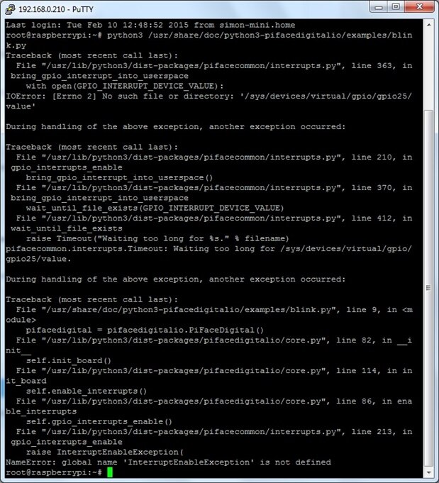

I have followed the Piface Digital 2 installation instructions to the letter, however receive an interrupt error on line 213 of the Interrupts.py script when I try to run the blink.py script. I am using python 2 by default, but have tried to run the blink.py script under both python 2 and 3. I have attached response in both versions.
At first I thought the problem may relate to the SPI driver, but I have enabled the port and tested it by bridging the MOSI and MISO pins and running spidev_test.c. I receive the correct response.
Starting blink.py (or any of the other example programs) with python 2 gives the following result
Starting blink.py with python 3 gives the following result
Any help would be greatly appreciated.

    Hi,
    This error is due to changes in the new version of Raspbian. The latest package (>v4.1.2)  for python-pifacecommon should fix it. There might be a slight delay as it makes it way through the mirrors, but once that happens, doing a
    sudo apt-get update
    sudo apt-get install python{,3}-pifacecommon
    should fix it.
    Regards
    Andrew

    Hi Andrew
    I finally received the Pi2 and as you predicted the pifacecommon update resolved the problem.
    I can now run blink1 and all is fine. I then tried to create a very basic script which set up the input interrupts as per the example and then switch an output on and off based on the status of an input. (When input 1 is pressed then turn on Output 1). This works fine using the GPIO, but not with piface. I have included the script below. I receive an Attribute error: 'int' object has no attribute 'chip'. I am well out of my depth here and no doubt I am making a very obvious error. Your help would be greatly appreciated.
