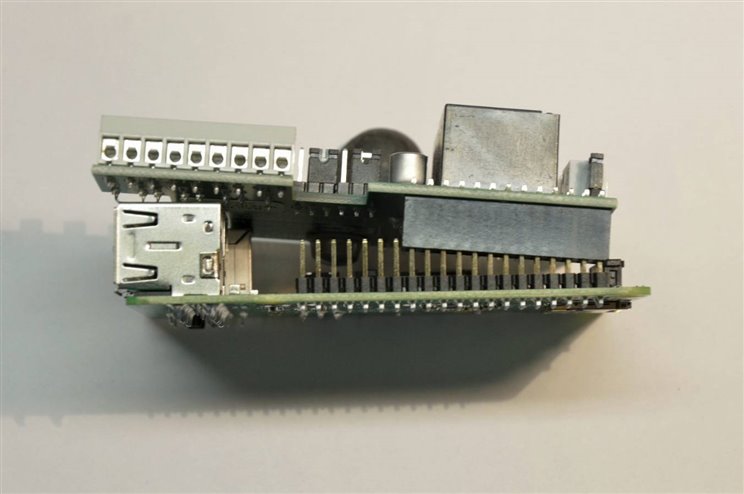

    better hanging than this ...

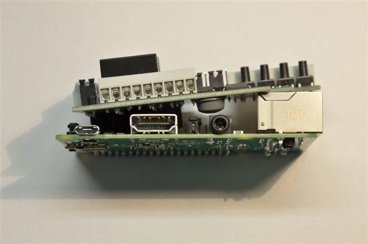

    0 e14 Contributor over 11 years ago in reply to Robert Peter Oakes
    I am totally new to this, but didn't I see a stacking adapter for this problem somewhere?
    0 mcb1 over 11 years ago in reply to e14 Contributor
    you mean the one four posts ago ??image
