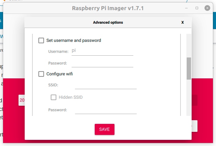

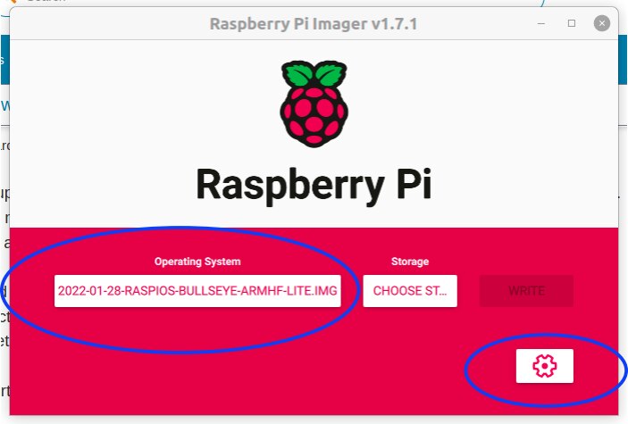

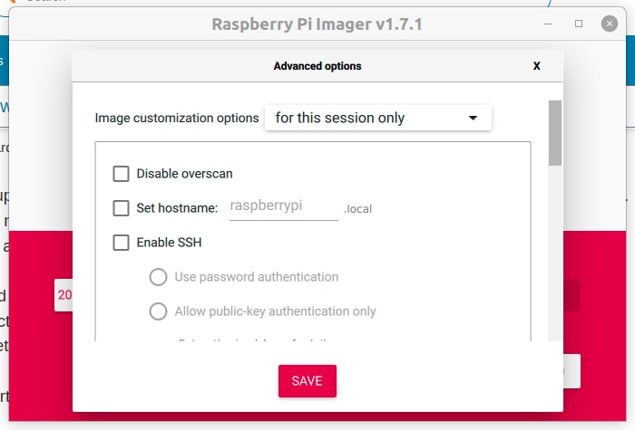

    I've attached some Linux screenshots. Looks to be slightly different than your version.
    {gallery}Imager options
    gear appears after O/S selection
     gear options
    gear options
    After the operating system is selected a gear appears. Select the gear and a scroll menu of options are made available.
