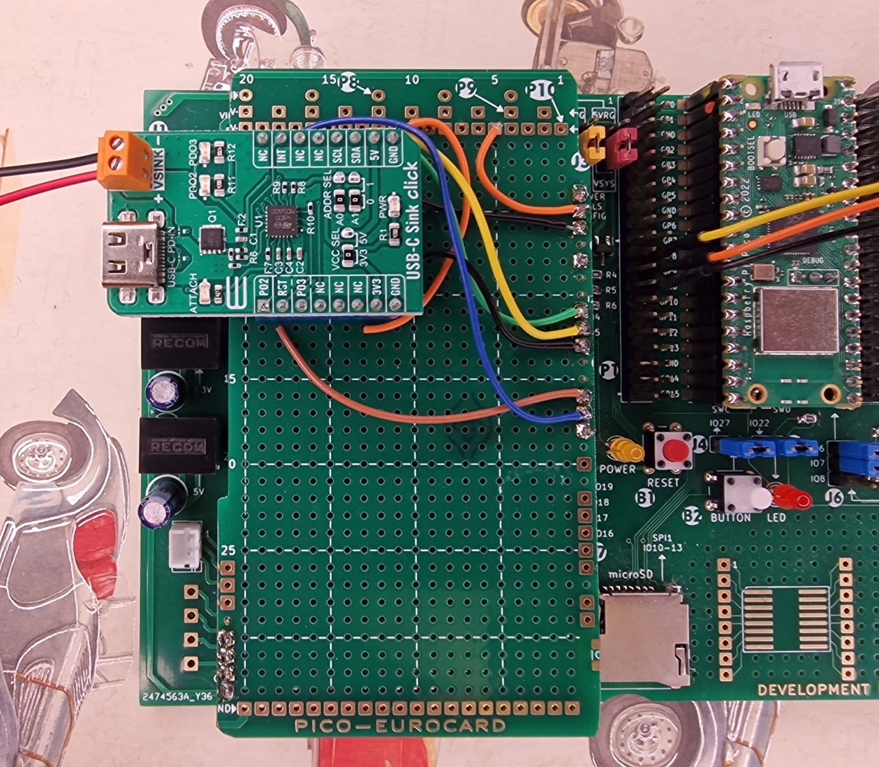

    I'm MicroPython'ing currently. The board can accept stripboard or perfboard plugged on, so I used an older scrap version of the board chopped up for its perfboard area.
    This is a MicroE click board (i.e. Mikrobus), wired to the I2C and 3.3V and a couple of GPIO.
