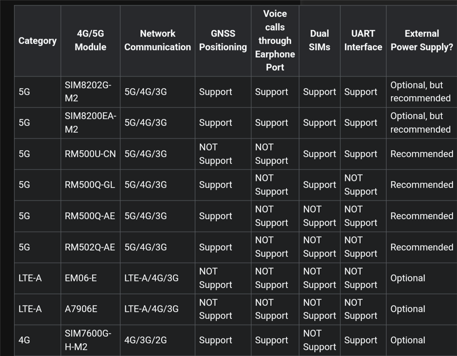

    Hi. I would like to update the progress. I have tried what you suggested balajivan1995 . But it was not a success either. I tried checking the design file, and I found that there is no UART pin available. The only available interface is the USB and PCIe.
    Could it be the reason why I am not able to communicate through the UART? If so, what would be the best way to communicate the 5G modulewith the controller?
    Appreciate your help on this matter, shabaz  and balajivan1995 . Thank you.

    0 balajivan1995 over 2 years ago in reply to meera_hussien
    I don't have any experience in PCIe communication. As for the USB, we can try two things,
    1. Connect USB to UART TTL to the board and connect it to ESP32's UART and hope AT Port is accessible through it.
    2. Change ESP32C3 to ESP32S3 or some other controller that supports USB host communication.
    In this section, they've mentioned UART port is accessible in 3 modules, are you sure yours is not one of them?
  • meera_hussien
    0 meera_hussien over 2 years ago in reply to balajivan1995
    Yes balajivan1995 . I using the RM502Q-AE.
    I will change the controller board and try to see if it can work.
    Thank you.
    0 shabaz over 2 years ago in reply to meera_hussien
    It may be worth first confirming operation with a Pi. According to the Waveshare website, the UART is the only interface connected to the Pi.
    If the interface really is only USB and PCIe, then there's little hope of working with ESP32.
    There is a chance that USB may work, but only if ESP32 can operate as USB Host (which I have no idea if it can, but hopefully it is documented somewhere), if the interface on the Waveshare card is USB peripheral.
