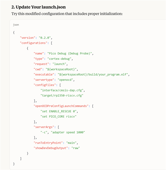

    +1 BigG over 1 year ago
    Tried Claude 3.7 for insight:
    https://claude.ai/share/5c40ee71-5752-451a-a4bd-4a0c04cd7ba1

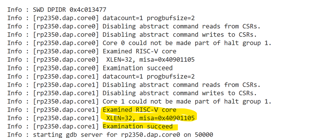

    This got me a step further!
    It's not breaking or stopping yet, but finds the cores.
    The part that got me to this:

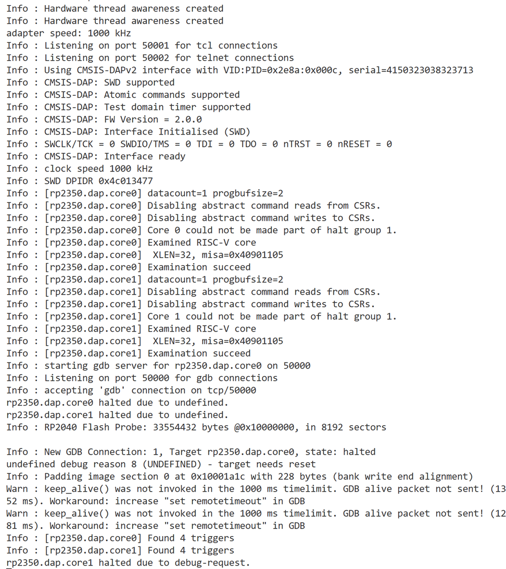

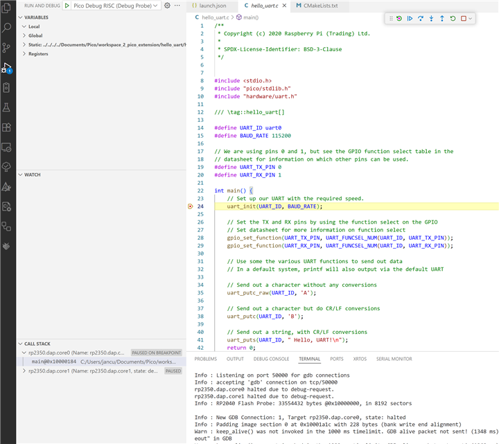

    0 Jan Cumps over 1 year ago in reply to BigG
    Fixed!
    I needed to adapt the launch.json, based on these instructions:
    not 100% exact, but close enough to put me on track.
    Here's the actual script I added:
                "name": "Pico Debug RISC (Debug Probe)",
                "cwd": "${userHome}/.pico-sdk/openocd/0.12.0+dev/scripts",
                "type": "cortex-debug",
                "request": "launch",
                "executable": "${command:raspberry-pi-pico.launchTargetPath}",
                "servertype": "openocd",
                "serverpath": "${userHome}/.pico-sdk/openocd/0.12.0+dev/openocd.exe",
                "gdbPath": "${command:raspberry-pi-pico.getGDBPath}",
                "configFiles": [
                    "interface/cmsis-dap.cfg",
                    "target/rp2350-riscv.cfg"
                "openOCDPreConfigLaunchCommands": [
                    "set ENABLE_RESCUE 0",
                    "set PICO_CORE riscv"
                "serverArgs": [
                    "-c", "adapter speed 1000"
                "runToEntryPoint": "main",
                "showDevDebugOutput": "raw"
    gdb server log:
