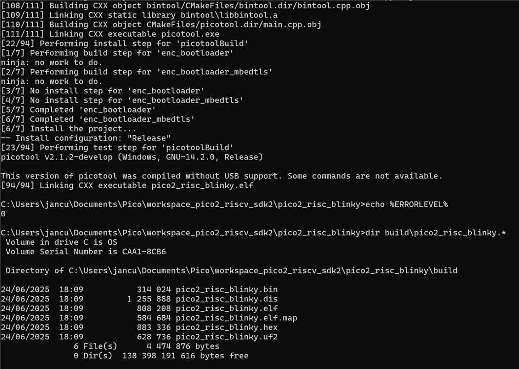

    When I run my make file outside VSCode, I get success:
    0 Jan Cumps 10 months ago
    solved:  Use the Pico RP2350 in RISC-V mode without Pico VSCode Extension: build
