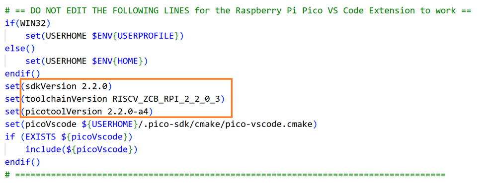

Why work without extension?
The extension leaves a footprint in your CMake file. Part of the inserted settings, I'd prefer not to have in a makefile that I publish on GitHub: SDK, toolchain and picotool version.
If you work with several users on the same project - or on multiple PCs - it would require that everyone uses the same version of these. While that may not be required for your project. This doesn't work well with version control and team efforts.
The rest of the extension footprint in the CMake file, I don't like either. But it doesn't put any restrictions on users with a different setup - or without the extension. I'm OK with those.

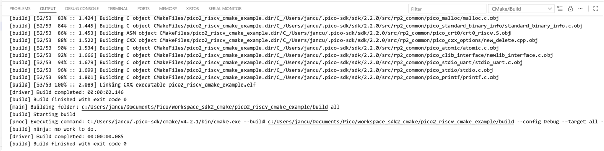

How do I use it?
I install the extension, because it's the easiest way on a Windows machine to get all required software. And the easiest way in VSCode to create a ready-to-go project.
When I create a project for myself, or something I want to try out, I use the extension. If that project has one single target, I use the full extension. If I want to create multiple firmware binaries (e.g.: an I2C and a SPI variant of the same project), I use the Extension, with CMake Tools enabled.
For a project that goes to GitHub, I use plain CMake scripts, without the extension. In VSCode, I then use the CMake Tools extension to manage toolchains, configure and build the project. This extension doesn't alter your build scripts.

There is version info in the fille (line 1 - 4). But they describe either a minimum version, or the standard used. You can use different toolchains or build infra, as long as they offer the required functionality or standard.

You can set them in your operating system, on the CMake command line (with -D<variable>=<value>) or in your IDE, if you use one,
The image below shows how to set them in the VSCode CMake Tools extension:
  • debug config : a follow up post, I'll show how to get a PicoProbe / Pi Debug Probe working in VSCode, when a project doesn't use the extension.
