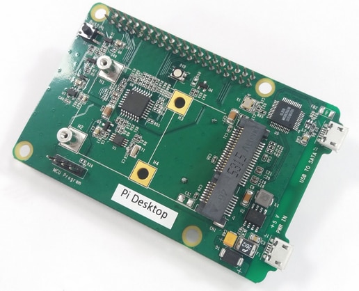

Hello,
I have a Desktop Transformer Kit for PI3 + SSD.
Purchased in 2018 from McHobby.
I would like to know if it is possible to use the "Pi Desktop" board and case with a Raspberry Pi 4 - Model B - 4 GB?
Thanks
    shabaz over 1 year ago
    Hi,
    The Pi 4 has higher power consumption, which the Pi 3 desktop kit may well not have been designed for. Unless there's documentation to suggest otherwise, or if anyone has tried it, it's probably not going to be a seamless thing, without configuration to perhaps reduce Pi power consumption. You could just try it, but you might have the risk that some damage may occur to the kit.

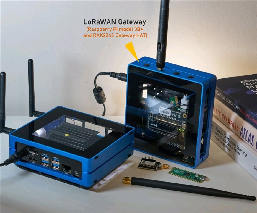

    Also this one is nice: re_computer case from Seeed:
    https://www.seeedstudio.com/re-computer-case-p-4465.html
    It fits about half a dozen different SBCs, including Pi 3 and 4, because it comes with a load of interchangeable panel plates. Another nice thing is it's spacious to add extra things inside, and easy to modify. I drilled a few holes in mine on the side, to fit an antenna, and the Pi Camera. (EDIT: I was mistaken, the antenna holes are already there, plugged up). Can also fit lights inside since the top is clear (I wanted to make the lights be white, but blink a different color whenever there was any LoRaWAN comms, but didn't get around to figuring out how to do that).
    The top is magnetically held in place, so it's quick to pop off to mess about with the electronics if required.
    Edit: Found a photo.
    In the one on the left, you can just about see the white flex for the Pi Camera, in-between the two antennas. That case doesn't have a Pi inside, but the unit on the right contains a Pi 3.
    Also for the one on the left, there are strips of LED lights pointing down, they are glued to the underside of the black surround of the top clear panel.

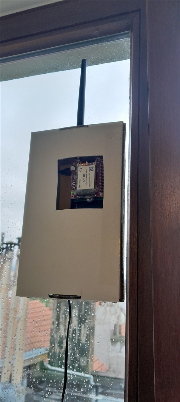

    Jan Cumps over 1 year ago in reply to shabaz
    My LoRaWAN version :)
