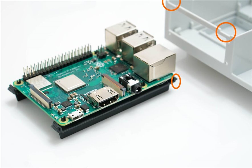

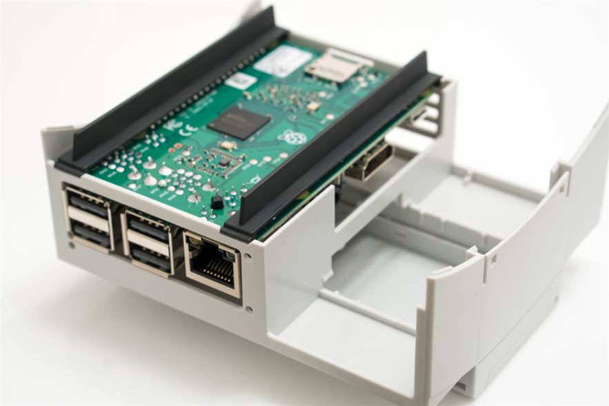

Installing the Pi
The RPI-BC uses a nice way of positioning and securing the Pi. There are a couple of black plastic rails that clip on to the Pi to act a carrier. There are lips that fit the shell of the case, and then the Pi is secured when the other half of the shell is attached.
Once installed, the power supply micro USB connector and HDMI and audio connectors are accessible inside the enclosure which is great – they are unlikely to all need exposing outside, but cables can be routed in the empty space if needed.

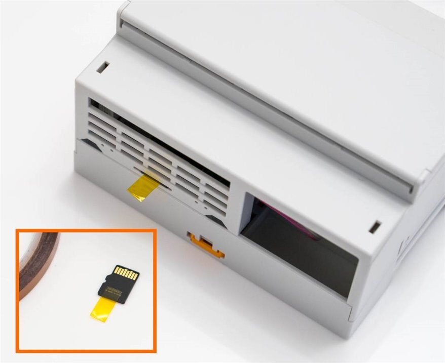

The carrier rails ensure that the Pi is very accurately positioned inside the case. That’s needed, so that the micro SD slot and LED holes are also positioned accurately. Incidentally since the Pi’s micro SD card is not ‘push to eject’ but is ‘pull to eject’, if the end user will need to remove the card with the enclosure closed, some tape on it helps.

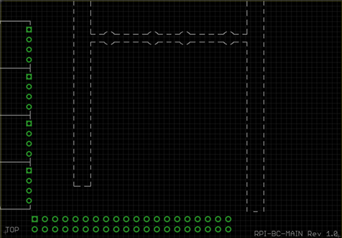

Some Phoenix Contact prototyping boards for the RPI-BC are available; one prototyping board plugs onto the Piprototyping board plugs onto the Pi, and another prototyping board fits the space to the sideprototyping board fits the space to the side. To make custom PCBs easier, so I took the dimensions, and made up an EAGLE CAD part (attached to the bottom of this blog post).
The parts required to assemble such a custom PCB are a 40-way connector strip40-way connector strip and optionally up to four 4-way connectors4-way connectors.

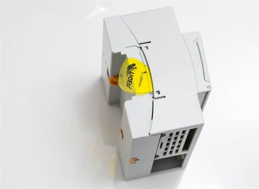

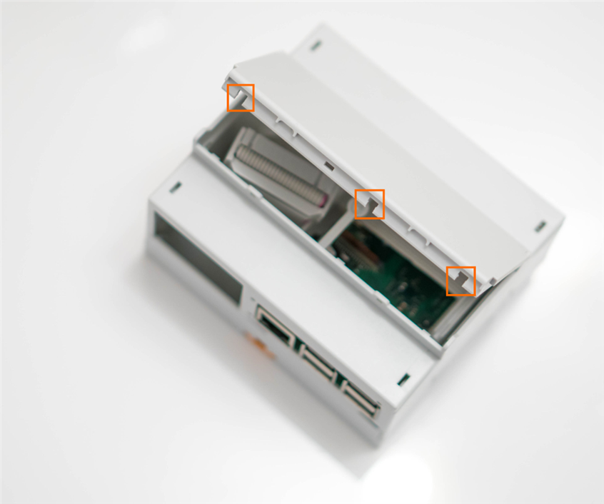

Un-clipping the case
The two main halves of the enclosure clip together. They are easy to disassemble using thin plastic such as a guitar pick.

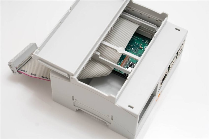

Using a Ribbon Cable
If you’re unsure what circuitry to attach, that decision can be left until later : ) by using a ribbon cable plugged onto the Pi instead of the previously-mentioned PCB. I used a 40-way insulation displacement connector40-way insulation displacement connector (IDC) and a 26 way connector26 way connector and 40 way ribbon cable40 way ribbon cable and the cable assembly can be left inside the case, or it can be brought out through the holes on either side of the enclosure. There’s enough space to make a small PCB in future that the 26-way connector can plug onto. To make the cable assembly, a 40-way cable was used and it was slit and cut. A vice can be used to close the IDC connectors.

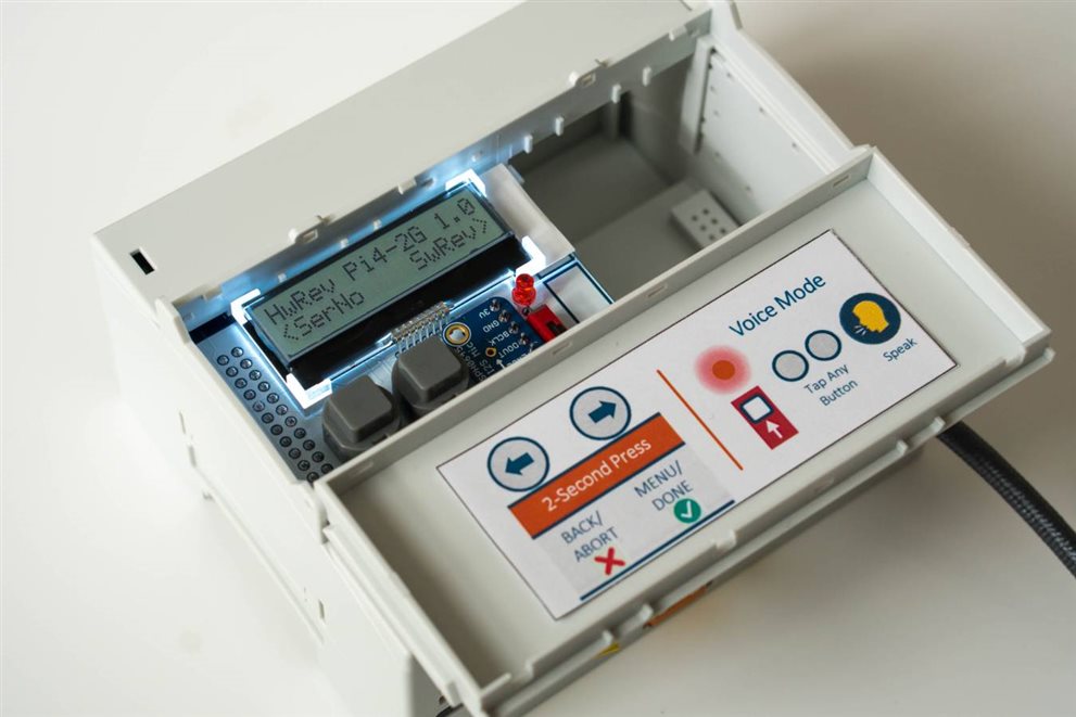

The front panel can have holes drilled for buttons and LEDs and so on, and it permanently clips onto the front of the enclosure, however it could be turned into a hinged flap if desired, by cutting out plastic in three areas before attaching it on (there is an optional front panel order code that doesn't need this manual modification).

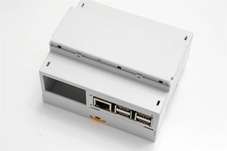

Putting it Together: Raspberry Pi 4 and Custom Board
The photo here shows an example board designed with EAGLE CAD, installed along with the Pi 4, into the enclosure. The flap covers the display/controls and hinges open to reveal the user instruction sheet. The flap could be replaced with a 3D printed version with holes for the display and buttons if desired.
