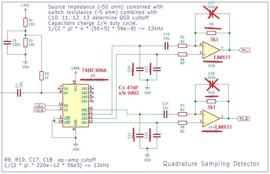

I don’t have all the exact components used in the project.
I made the following substitutions with similar components I had on hand
The frontend low rdson analog multiplexer was replaced with a 74HC066 quad analog switch (plus a one hot decoder).
I also lowered the gain of the op-amp difference amplifiers.

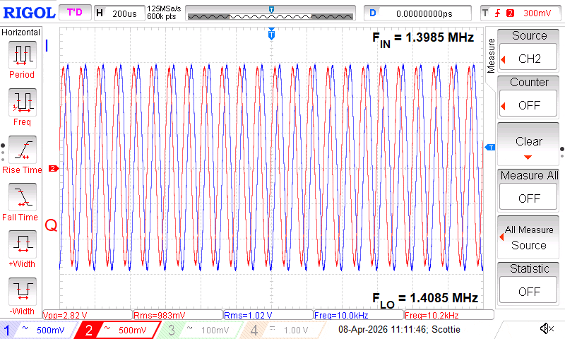

On power up, the picorx software defaults to an LO frequency of 1.4085 MHz.
I used my signal generator to apply a 150 mVpp carrier with a frequency that sweeps from 10 kHz below the pico’s LO to 10 kHz above the pico’s LO.
I get wonderful sinewaves on the output I/Q channels:
The quadrature detector has significantly more bandwidth than I expected.
You will notice that for frequencies above the local oscillator the Q signal leads the I signal (and vice versa for frequencies below the LO).
The QSD’s response within 1 kHz of the LO is being partially rejected by the AC-coupled difference amplifiers.
The amplitude response of the I/Q channels is not very well matched (I will have to think about that for a bit)
More to experiment with, but impressive results for the simplicity of the project.

    Nice results! There may be noticeable difference with the various substitutions, because of the higher switch resistance (and I don't know how matched they are, although they should be near-identical since they are all on the same chip), plus the load on the sampling capacitors is different for the different inputs of the op-amp (but then again, it was different for the original circuit too). I guess it would be nicer to also have a quad op-amp serving as a same-load buffer for each sampling capacitor, but maybe the effect is negligible (I've not seen any circuits have any buffers either admittedly).
    Regarding the switches, In the past I tried a SD5400CY, perhaps the 3253 is better (it's seen a lot in online circuits, whereas the SD5400 is rarely seen) simply because I thought there was less inside to be mismatched or cause any other switching noise from all the additional MOSFETs in the silicon in the 3253), but I've never compared. SD5400CY is harder to find and too pricey now (in the past it was very cheap) so those are negatives too.

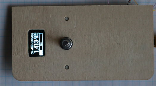

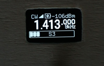

    Spent some time putting the UI bits on a front panel. Most of the configuration options are only available via the physical UI, not the usb serial interface.
    The author did a nice job on the UI, it looks sharp.
