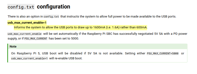

I’m using a Raspberry Pi 5 with an NVMe SSD connected through a USB 3 enclosure. The Pi works normally when the SSD is disconnected, but occasionally reboots when the SSD is under sustained read/write load.I purchased this one in Italy, so it might function differently.
The power supply is rated at 27W, and the issue seems more likely to happen when the CPU is also under load. Has anyone seen this with the Raspberry Pi 5, and would using a higher-rated USB-C supply or a powered USB hub be the recommended solution?

    I'm using the M.2 HAT+ to access the NVMe SSD (uses around 5W on R/W, running SLM's) , it works without any problem. If the power supply you're using doesn't have the 5V 5A profile, it's also a cause of the issue you're facing.
    Yes, thank you. This's the particular USB-PD profile that the Pi 5 is fussy about.

    The problem might be with the enclosure, sometimes they do not expect higher power pull which has changed depending on what PCIe standard they expect/support.

    I've just checked what I have.  The case is an Argon One V3 m.2 https://argon40.com/en-gb/products/argon-one-v3-m-2-nvme-case.  The power supply is an official PI supply, P1224, rated 5.1V 5.0A (the 27W version.)  The power supply connects directly into the case through a USB C port.  I see there is a higher powered supply, 45W, but that is profiled at 9V 5A and offers the same 5.1V 5A profile so I can't see it making any difference.  I don't know that power is a problem in any case!
