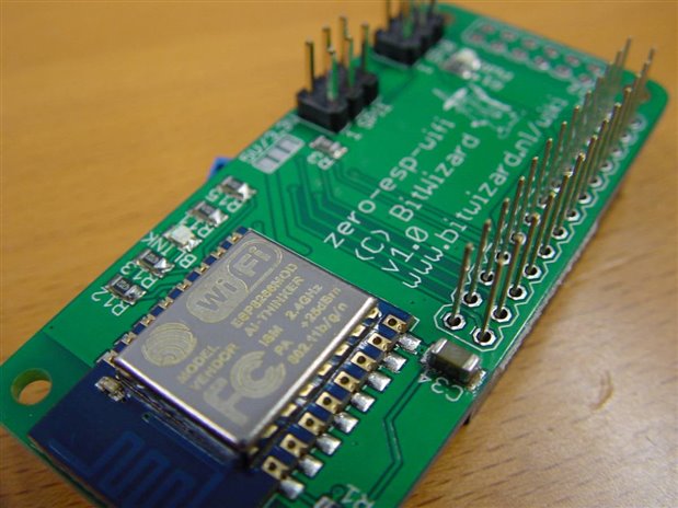

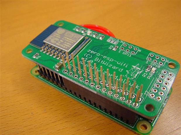

I've designed a board which plugs onto a raspberry pi zero to provide WIFI through an ESP8266 module on the serial port of the Raspberry pi.
Now you may say: Why not just use an USB-wifi dongle? Those are cheap and work out-of-the-box! You're right. But in some cases that's not the best solution: When you are space-constrained and need exactly ONE usb device, not having to use a HUB pays off. imageimage
I have not yet soldered on the connectors in these pictures, to facilitate other configurations should that turn out to be practical.

    That looks like a really neat board! image
    I am a bit tight for time at them moment, but I'm curious what you mean by making the wifi part useful?

    Kinda of curious, but how are the springs contacting the Pi Zero? They do not use the 40 pins or do they?
