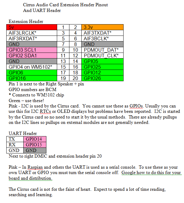

The Cirrus card has a 20 pin extension header and a three pin UART header that give access to RPI GPIOs, I2C and UART.
I had to scrape all this info together for my own projects so I thought I would share.  As usual the info was buried in multiple documents and posts.  Let me know if there are any corrections or additions.

    Thanks ! I was looking for confirmed data on this CLAC  expansion header.
    And It seems you found and corrected the data from the schematics.
    I just started a new thread to find this info, so Let me redirect that to this thread.
