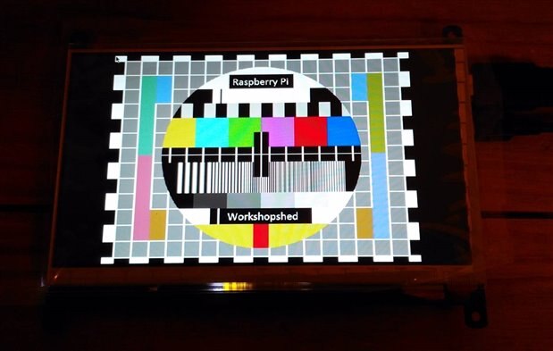

    Picked up a Makibes 7in touch screen and got that working in just a few minutes. Definitely a much more sensible approach to this challenge. I got a small refund from the people who sold me the board with the dodgy adapter so that I could buy replacement cables. The adapter and original LCD will get filed for a later project.
    The display does work all the way to the edge but my test card is not a widescreen version.
    Jan Cumps over 9 years ago in reply to Workshopshed
    That looks like a good quality display.
    Isn't the molten cable the lesser issue you have with the first screen?
    Wouldn't you have to write your own driver from scratch for that one?

    Workshopshed over 9 years ago in reply to Jan Cumps
    Not quite sure what you mean there, the adapter card should do most of the hard work. It's getting tucked deep into the drawer so we may never know....

    Those driver boards take a standard VGA/HDMI signal and turn it into LVDS for the LCD, as Workshopshed said, it does all the hard work.
