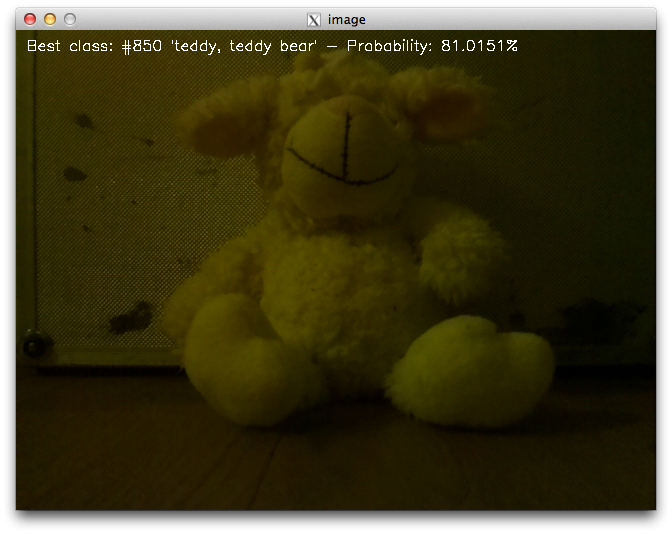

Test setup
I did all test with the same camera and SD card. I just exchanged the Raspbery Pi. The system is running Raspbian Stretch with Destop, Version March 2018, but the boot option is set to console only. Ethernet is connected, WiFi is off. Nothing is connected to USB, no monitor attached.
The system was installed and setup on the Raspberry Pi 3 Model B+ and then the same SD-Card was transferred to the other models.
During all tests the camera will see the scene on the screenshot below and identify it as teddy bear.

Do you have any ideas or comments on my measurements?
    genebren over 8 years ago
    Bernhard,
    Going fast has a price.  And in the this case it is more current.  Just a minor point, but the majority of your power is being dissipated in your regulator.  In fairness to your setup, your relative power usage is correct, but for actual power used by the Raspberry Pi, the power should be 5V*I not 12V*I (5 * 0.278 = 1.39W and not 12 * 0.278 = 3.336W, as 1.946W are be dissipated by your regulator.

    bernhardmayer over 8 years ago in reply to genebren
    Hi Gene,
    my power regulator is a Texas Instruments TPS54335 and it is a switching regulator. The losses should somewhere between 10 and 20 %. So the correct formula should be 12V * I * 0.8.
    Bernhard
    genebren over 8 years ago in reply to bernhardmayer
    Bernhard,
    Good point.  I would guess that you might closer to correct on the total power.  If you really wanted to know that actual power consumed by the Raspberry Pi in these test (and not artifacts of the regulation), the better test might be to measure the current delivered to the Pi and not the input current to the regulator.  The Pi power would then be I x E, where E would be 5V.  Either way, the readings that you took, really do show the effect of processing load on the Pi due to the calculations being performed.
    Gene,
    I have to admit measuring at the 5 V input rail would be way better.
    Unfortunately I only had the board with the voltage regulator and the measurement on the 12 V side. But I plan to make a PCB where I can connect the original Raspberry Pi power supply and measure directly on the 5 V. But again, it will take a few weeks until the new PCB is here. Then I will do the measurements again.
