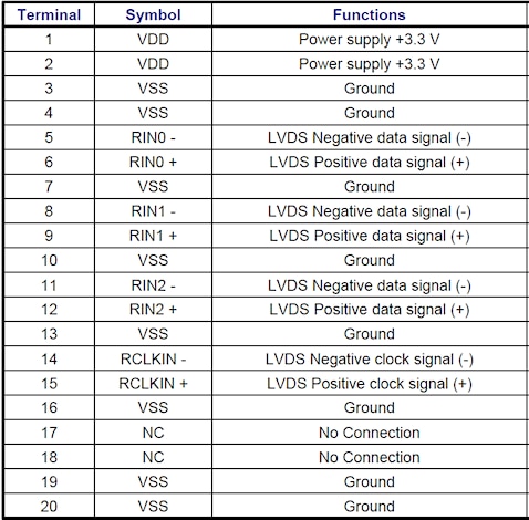

i just breakdown of components from old Macbook Pro 13" that i was. the screen was perfect and i want to use that screen and connect to Raspberry PI 2 b+.
so i did that tutorial: https://www.ifixit.com/Guide/MacBook+Pr ... ement/4311
and now i have the screen , what should i need to connect it to the RPI2 that i have?
its look like 30 pin ttl cable and i cant find any driver that will help me (with HDMI)
any help ? please?
Pictures at that link : https://imgur.com/a/85DNz1n
Also i find that datasheet of the screen (attached)
imageLP133WX2-TLG7-LG.pdf

    Laptop screens often use LVDS as the connection. I can't see the images as imgur is blocked for me at work, but google "Raspberry Pi LVDS" or "HDMI to LVDS" and see if things start looking similar.
  • Fred27
    Fred27 over 7 years ago
    Just checked that PDF and it definitely mentions LVDS.

    yes its LVDS but the screen needs some driver i guess i dont know witch driver
    is the perfect for that screen (with HDMI) i want to make it second screen for my PC
    i have that driver at home : pcb800099 v.9

    The LCD will not interface directly to your RPI.
    A specified previously look for an HDMI to LVDS converter.
    You will also need to check out the pin outs for this device vs the LCD as although it's a Pseudo standard there in fact many variations of the Pin out for a given LCD.
    To be honest unless there is a specific reason to use this LCD you may find it easier to buy a Monitor or a pre done HDMI Panel.

    Fair enough , best thing is to buy an HDMI to LVDS converter , there are modules available:
    https://www.google.com/search?q=hdmi+to+lvds+module&ie=utf-8&oe=utf-8
    You will need to make your own adapter cable though so you'll need to find the Pin out for the LCD panel
