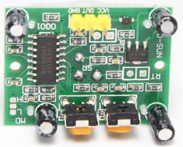

Apologies for this newbie type question, but I can't figure out how to use inputs on a PiFace Digital2.... I would like to connect up a PIR to a to this device and have come across instructions here Review of PiFace Digital , which even has sample code, but it's not clear to me which wires go where.
Any guidance would be appreciated.

    It would help if you could specify the type of PIR you are trying to use? Is it an alarm system type PIR that needs a 12V supply and has a set of NO/NC relay contacts? Or is it a 5V module of sorts that has a logic signal output?
    In general, you need to power the PIR (+ve and GND) and get a signal from the PIR. If the PIR outputs a logic level signal, you could use the digital inputs and connect the PIR output to one of them. If the PIR is a relay output, then you will need to configure a pull-up using resistors to provide an appropriate logic signal.

    It's one of these:-
    https://projects.raspberrypi.org/en/projects/physical-computing/13
    On mine the pins aren't labelled, but I assume they are standard as in https://howtomechatronics.com/wp-content/uploads/2015/09/PIR-Sensor-Pinout.jpg?x57244
    dougw over 7 years ago in reply to balanga
    I think you are correct about the pinout:
    https://www.mpja.com/download/31227sc.pdf

    From my searches, I should connect:-
    VCC to GPIO pin 2
    OUT to GPIO pin 7
    GND to GPIO pin 6
    according to https://www.researchgate.net/profile/Zakaria_Rada2/publication/312218161/figure/fig3/AS:449572641218564@1484197878779/GP…
    but am unsure how to map these pins to the PiFace Digital2...
    Having said that this diagram https://projects-static.raspberrypi.org/projects/physical-computing/0cb2cbd34292a05a668aeea3f291ceb3c7d9cd83/en/images/p…  appears to have the pins inverted....
    This diagram http://www.piface.org.uk/static/img/piface_digital_2/pifacedigital2_diagram.png  show two possible locations for VCC and three possible locations for GND. Does it make any difference which I choose? And am I correct in thinking OUT must be one of the eight green terminals?

    Operating with and without the PiFace Digital is slightly different. The diagrams you have before are designed for direct GPIO interfacing rather than going through an I/O expander such as the PiFace Digital. The principles are, however, much the same.
    The VCC line should be connected to any of the 5V outputs from the PiFace Digital, the GND line should be connected to any of the GND lines on the PiFace Digital and the OUT line can be connected to any one of the input lines on the PiFace Digital. Your code should read the corresponding input line to find out the status of the PIR.

    I finally managed to get this working connecting the OUT pin to the terminal 0 of the input row.  I'm using the following code:-

    The example that was referenced looks like a PiFace Digital rather than a Digital 2 but should be similar.  From my understanding, the first 4 (0-3) inputs/outputs are tied to the switches (S0-S3) so the example skips these to set LEDs 4-7 by offsetting the value from the 'for/range' loop with "pin_number+4" .  However, the "if" statement is only checking for inputs 0-3 which would be one of the switches or an input from 0-3 but then sets an LED, 4 plus pin_number (4-7), which seems odd.  The example also is using 4 PIR sensors, so if you have only 1 PIR sensor then you could remove the for range loop from the code example.
    If you want an output on say output 4, then you should put the Out from the PIR sensor to Input 4 on the Digital 2.   However, I found the inputs on the Digital 2 are tied to 5v which causes an issue with the Parallax PIR sensor so I place a 10K Ohn resistor between the input port I am using on the Digital 2 to ground (GND) to ensure the PIR reading is clean.  You can disable the pull-up on the input of the Digital 2 but that causes them to float so you would still have to to either tie it high or low depending on the device connected to the Digital 2.

    I'm trying to figure out what is going on... I have the Delay Time setting to max, which I think is around 7 secs, so I guess each output of 'hello' is a result of polling which must be taking place every .001 secs over 7 secs.
    How would I go about printing a single 'hello' after motion has been detected?
    If sensor == 0 set a flag = 0.
    print if the flag == 1 and the sensor == 0.
    When the signal == 1 set the flag = 1.

    From my experience, a PIR sensor stays active for a period of time after it senses motion, so I would suspect this is what your are seeing.
    You could put another while loop after the if statement to have it wait for the input pin change state again such as:

    Did you tie the input pin low with a 10K resistor to ground?  This will ensure the pin is 0 when the signal is not present.
  • jomoenginer
    jomoenginer over 7 years ago in reply to balanga
    So, I tested this with a RasPi B+ and Digital 2 and after looking at some previous code I had I seemed to have missed something in my example. I found for the PIR sensor, it was best to disable the pullup on the Digital 2 for the pin you are reading an input from.
    This is accomplish by adding the following:
    pfio.digital_write_pullup( pin_number, 0 )
    This seems to work in my config and should give you idea of what is needed to read the input:
