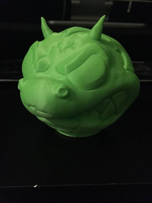

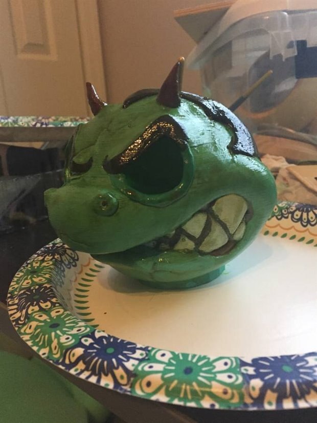

Hey everyone!
I'm a puppet builder/composer/ jack of all trades working on my next project: My own original fortune teller machine.
To get it out of the way right off the bat: I'm NOT a programmer. I can figure SOME stuff out but 99% of coding I'm not good at at all.
Now onto my project:

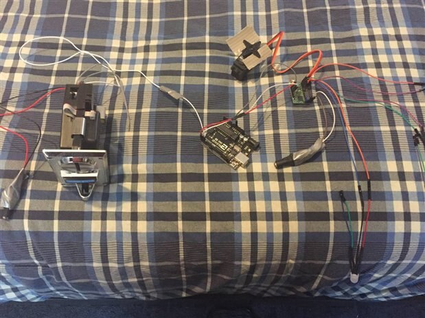

So thus far, I have gotten the entire automation done (not shown are the LED lights)
I used a Mini Meastro 12 Servo Controller, 1 servo, and 3 LEDs (Monk RGB LEDs with built in resisters)
The head is 3d printed from a model I did in Sculptris, and the music I composed myself.

Using a coin acceptor:
https://www.adafruit.com/product/787?gclid=CjwKCAiAsoviBRAoEiwATm8OYB6kjzT62LsyP2nW9KEgcXrX4rUOxXm75hvwpg-ig9-FBbzy2ptia…
to activate the sequence.
To have the audio track play at the exact moment the sequence starts (the audio in the video is from my PC Speaker that I hit play to sync with the sequence)
After the sequence plays, a random fortune is printed using a Thermal Printer:
https://www.adafruit.com/product/597
I'm using a Raspberry Pi 3 for this, but I also have an arduino uno.

    Understand what your saying, believe me this isn't easy. There are a bunch of fortune tellers that people have made using the Pi and even an arduino. So the desired goal is achivable.
    So I'm trying out the Arduino right now. As of this point, I'm going to attempt to get my coin acceptor to activate the automation
    I used this code:
    https://channel9.msdn.com/Shows/themakershow/10
    for the coin acceptor, and now I need to figure out how to get it to play the automation I made with the mini maestro
    I'll figure out the music after that step, right now I just need to figure out the activation portion. I wired the coin acceptor and the mini meastro to the arduino but I need to figure out how to get it all to work.
    If this doesen't pan out I'll try the Pi as originally intended. I do like that uploading code to the arduino is just plug it in, open the software and upload. The pi is a bit finicky with Putty/SSH.
    If anyone wants to help me figure this out, or walk me through this on the arduino OR Pi, please don't hesitate to help.
  • airbornesurfer
    airbornesurfer over 7 years ago
    One quick note that you should be aware of: Unless they've updated them recently, the Adafruit drivers for this model printer DO NOT work with a PiB3, so you'll need a B2.
    Coin acceptor should just send a logic "HIGH" to a GPIO pin when activated. Use that as an interrupt on the Arduino to trigger your activation function.
    My best advice to get the electronics working is to make sure you're absolutely familiar with the code structures for each of the components that you're going to add. Get one thing (for example, the motor movement and synching it to the music) done first, then add the coin slot, the lights, etc. If you make the build an iterative process, it'll be that much easier to string everything together later!
