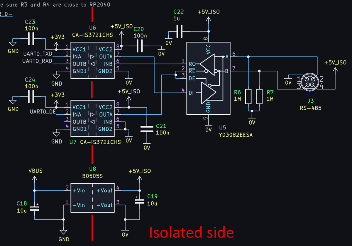

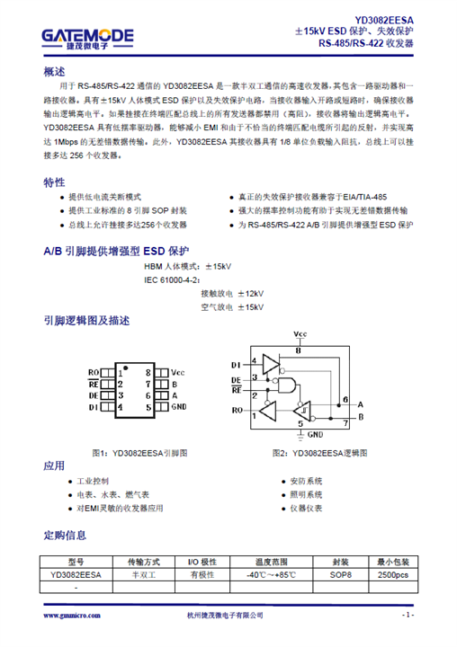

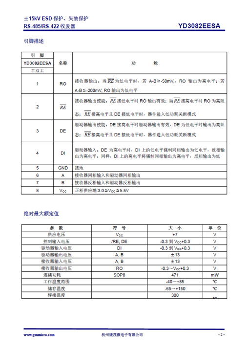

    Thank you for the details.
    Yes, that works so far. The selected RS485 transceiver work up to +-13V, it's ok for most usage. They are similar to the MAX3082E.
    CA-IS3080/86: -15V to +15V
    CA-IS3082/88: -7V to +12V
    Yes, your application works under these standards.
    One suggestion: I would use a selv-healing fuse (few mA) for the +5V_ISO output.

    Thinking hmmm,.... the web site of the manufacturer is offline? www.gmmicro.com
    Hmm...??

    shabaz 1 month ago in reply to geralds
    I used the circuit shown below, the 5V output on the RS-485 connector is just in case something needs to be powered up with that, ordinarily not used. There's an isolated DC-DC converter (located near to the Reset button) to power the transceiver chip and one side of the digital isolators (the high number of channel isolator ICs seem to often be out of stock, so I went with two 2-channel ICs). I hope this circuit is correct, I have not measured any voltages nor tried to apply +-15V yet admittedly : (
