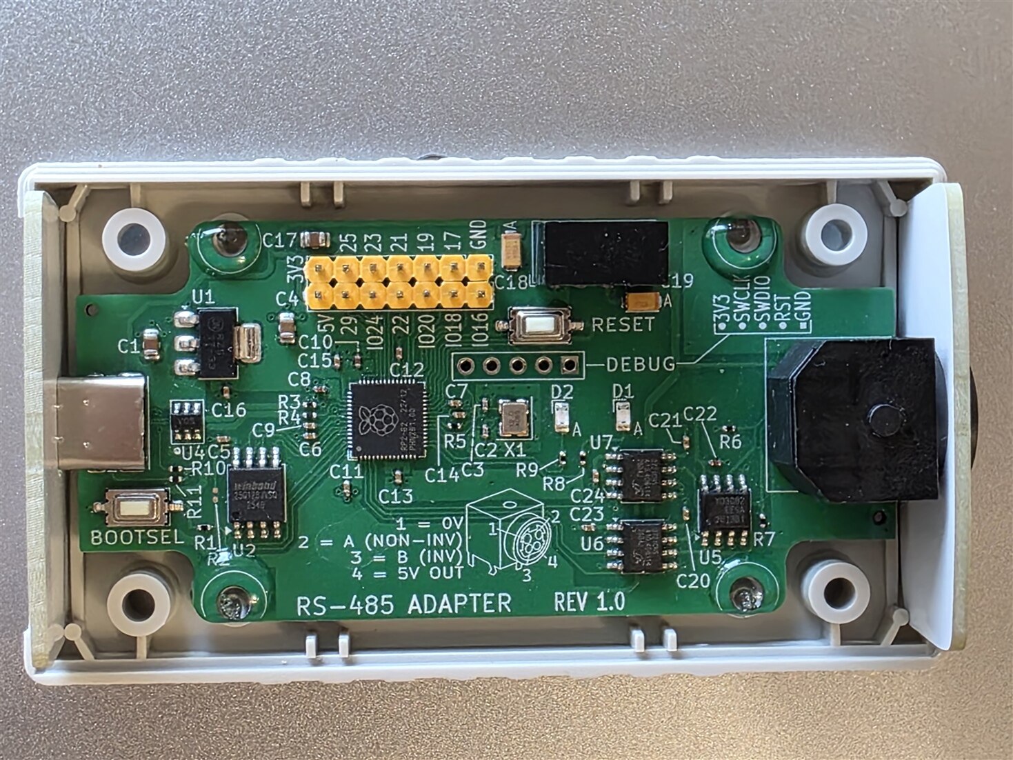

The first thing I did was to examine a sample board, to ensure components were oriented the correct way.
I'm glad we had an 0402 parts discussion, and the results of that can be seen in the photo below. I have not got out the protractor and set-square, but I think those parts are textbook-grade aligned!
The PCB is not densely populated, so there was space for very large component reference silkscreen text. With the settings shown below, the text is extremely readable in my opinion.
Here is the underside:
A through-hole USB-C connector was used (this cost a bit more for assembly as a result) but it was needed due to the particular enclosure I hope to use. The soldering looks good.
I don’t know how the through-hole soldering was done. The manufacturer portal indicated that the board went through a wave soldering process, but that would have solder-plugged the deliberately unpopulated through-hole pads that are on the board. Those through-hole pads are just lightly tinned, ready for inserting header pins if/when needed. Maybe the manufacturer masked the unpopulated through-hole pads.
For board bring-up some tests ought to be run first (and it would be very helpful to create some sort of a test jig), but I decided to just try one board immediately, since this isn’t a complex design. I held down the BOOTSEL button and plugged the USB cable into the PC. It was great to hear the Windows hardware detected sound, just as if it were a Pi Pico board that was plugged in!
The RP2040 has a built-in internal bootloader that makes the device appear as a file system, so all that is needed is to drag-and-drop the binary file onto the drive letter. A GPIO pin on the board is connected to an LED that is used for status, and it successfully lit up. I then ran some end-to-end tests (the board is an RS-485 adapter, so I tested that I could send and receive).
After that, it took just a couple of minutes to program up all the remainder boards in the same way. I have not tested these end-to-end, so for now I just observed that the status light was lit, which proves the CPU is running and that the USB connection is functioning.
The LEDs that were chosen are overly bright with the particular resistor values, but that's a minor issue. I should have also created a silkscreen location for serial numbers, but I forgot.
It is a relief that things have gone well. The changes made to the custom minimal project are published on GitHub (both myself and geralds  contributed to the content there) so hopefully it can be useful to others looking to make custom RP2040 boards too (and it would be super-interesting to hear if anyone plans to do something similar).

    shabaz 3 months ago
    Finally the board is in the enclosure.. and I learned that the board outline could be extended slightly in all directions. There's no easy way to screw in the board, because the holes are too shallow (they are just 2.5 mm deep), so I had to use glue (I used UV epoxy).
    End panels:
    Another thing I've learned; it would be good to use a right-angle button for BOOTSEL, so that a pinhole could be added to the end panel design, to make it easier to upgrade the firmware. Currently I would have to unscrew the case, or drill a hole in plastic, which isn't convenient.
    I need to modify the main PCB anyway, to add wireless to it. However for the current boards, I can use a daughter board, since the connections are on pin headers.
