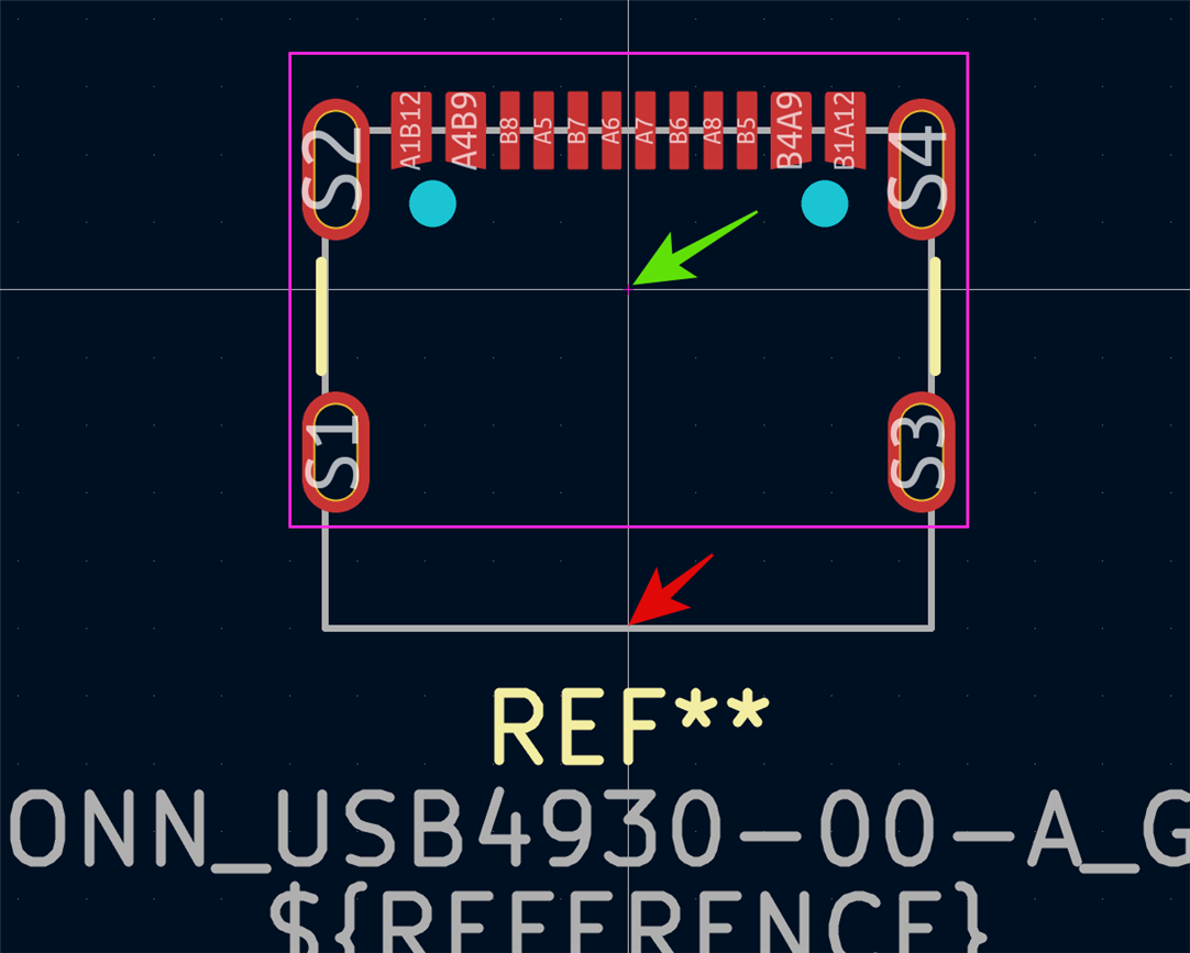

One minor issue was that the USB connections were in the wrong order for the USB-C connector which I wished to use. I could have mounted the connector on the underside, but that likely would make production more complicated or more expensive. To keep the USB connector on the top side, I had to swap the order by passing one trace through the center of a resistor footprint. It’s not nice, but it shouldn’t matter too much at the 12 MHz rate those traces carry.
Note that for board assembly reasons discussed later, you may wish to stick with surface-mount connectors and not through-hole.

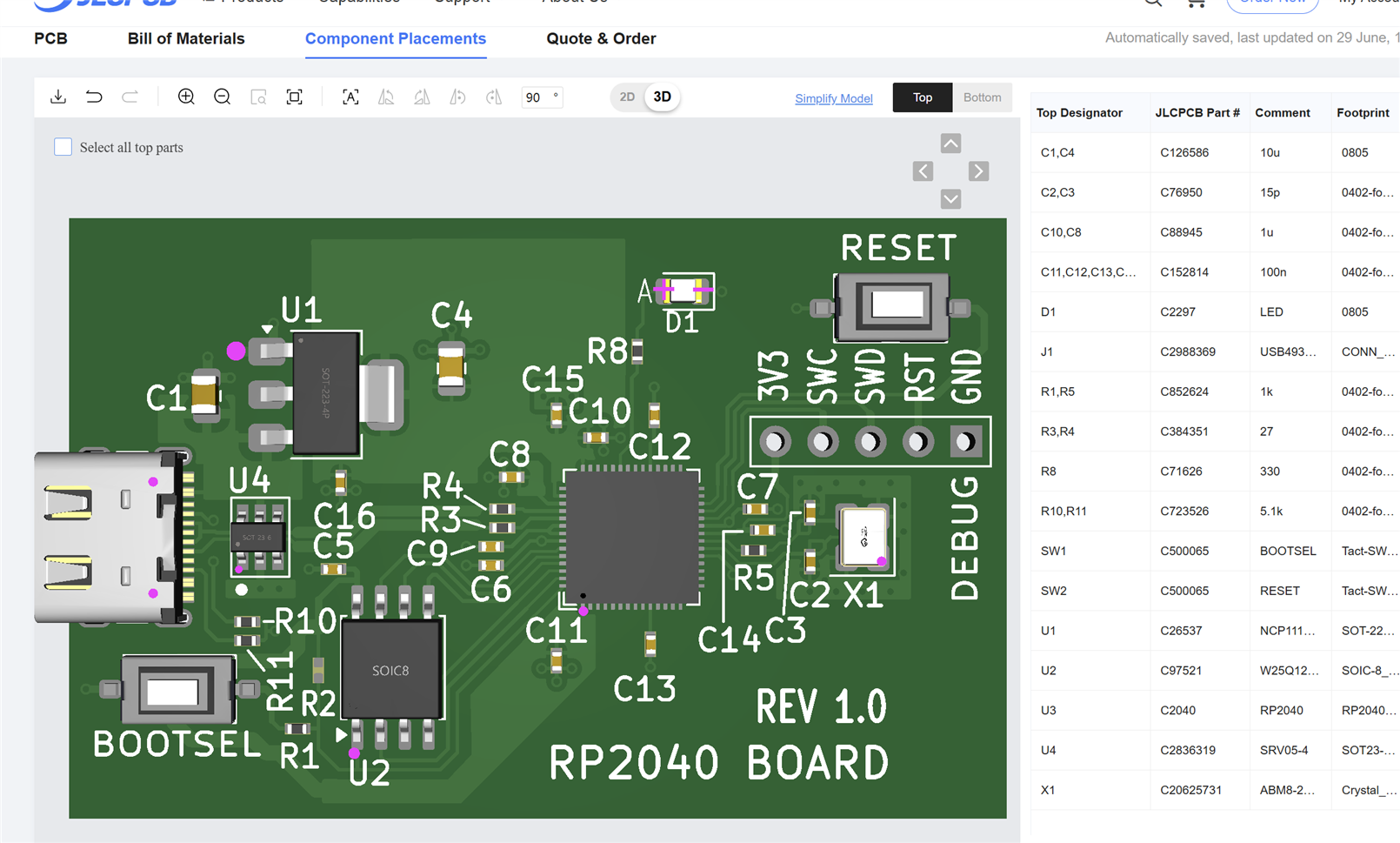

With the PCB manufacturer that I’m planning to use, adding the PCB assembly service is quite easy; I uploaded the Gerber files as usual for a PCB-only order, then scrolled down and clicked on PCB Assembly which was listed at the bottom. Then, I clicked Next and the website requested me to upload a couple of the files (BOM and Position CSV files) that were generated by the Fabrication Toolkit. The website then listed all the parts for review, then I clicked Next to see a PCB assembly render:
The purple dots indicates what the manufacturer thinks is pin 1. You’ll notice U4 is wrongly oriented, and R3 and R4 were unknown to the manufacturer. The simplest fix for R3 and R4 will be to choose different resistors (I just got unlucky selecting the ones that I did), and click on U4 and click on an icon just above the board rendering, to rotate. Personally I will try to fix in KiCad, and then re-upload, rather than make changes on the PCB assembly website.
I clicked Next again, and the cost was listed. This is for a quantity of 10, not including shipping and tax. You can see that I would have saved about $7 if I’d used a surface-mount USB-C connector instead of the one I did.

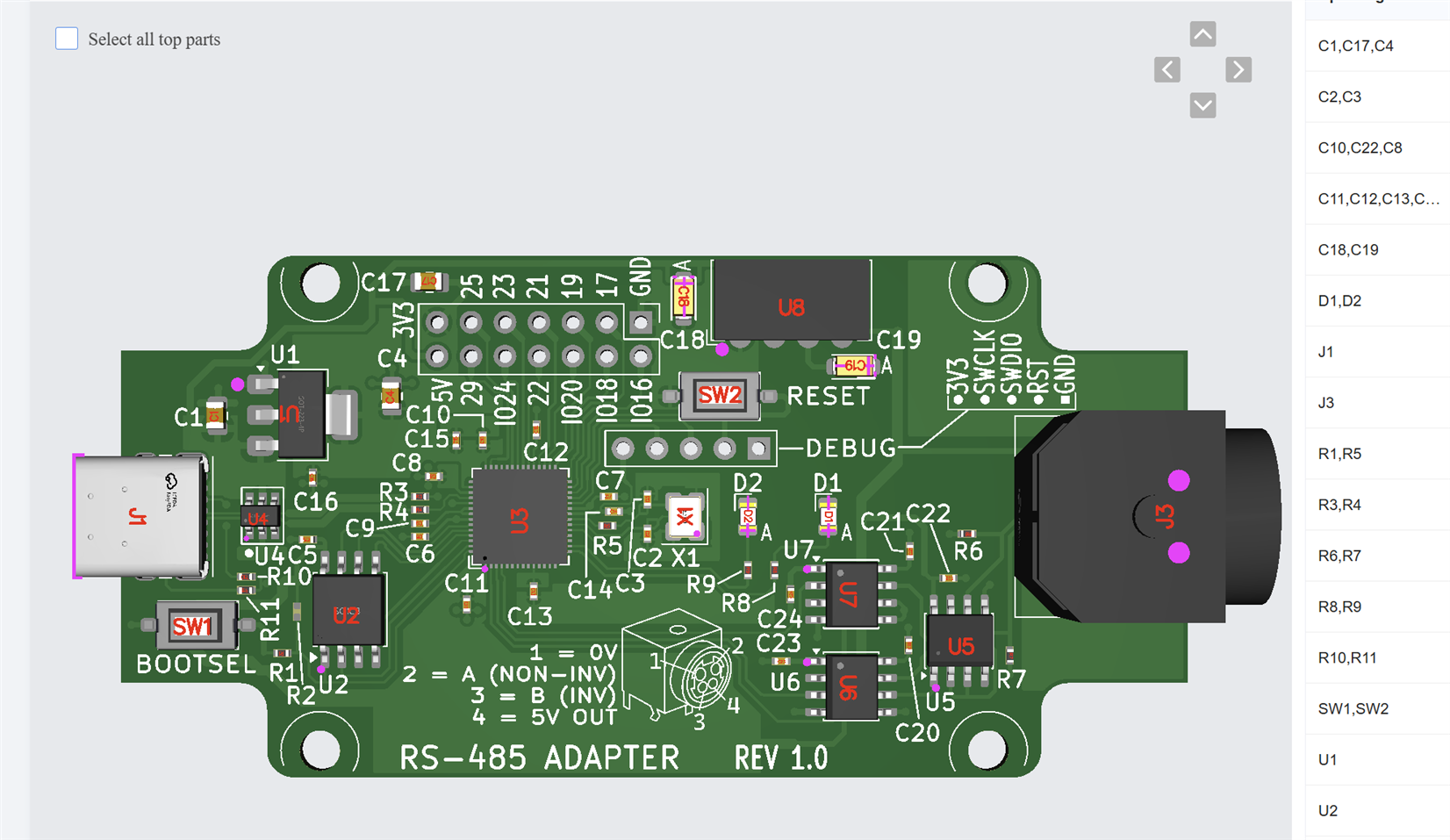

    I gave it a try! This is the minimal board with the additions I wanted. I uploaded the PCB files, and then at the bottom of the website clicked on PCB Assembly.
    The website prompted me for the BoM and Component Positions files (which were auto-generated by KiCad by clicking on the icon that got installed with the Fabrication Toolkit plugin).
    Then, I had to visually go over this rendering that the site created, to check all component positions and orientations were correct.
    This was the costing for a quantity of 10 (which is excessive, really I should only try a few boards first, but worst case I'll manually do some rework on these boards if needed).
    With tax and DHL shipping all included, it worked out to $214 total, which is £169, i.e. £16.90 per board.

    I tried uploading the design to a usual PCB manufacturer, and it looks good.
    Here's the costing for ten boards (add your shipping costs and tax on top of that).
    Of course, this is just for informational purposes, I'm not going to order this specific board as-is, since it's a minimal design with no GPIO connected (apart from an LED!). It is up to the user to append their own circuitry, e.g. header pins if nothing else).
    A couple of points regarding the online assembly service experience so far:
    (1) It can happen that the PCB assembly manufacturer is unable to render some of the components in the 3D view. They were displayed with a checkerbox pattern. I believe that means the manufacturer will ckeck the layout manually, so instead I decided to change the component to one that was recognized. This was an annoying iterative process admittedly.
    (2) Some components can appear with an offset or incorrect rotation. Rotations can be solved immediately by clicking an icon in the 3D view on the website (this is the simplest way but like me, some might prefer to go back and modify in their files), but if there is an offset, that's more long-winded. I had to move the component in the footprint editor (i.e. select all, then right-click and from the pop-up menu in KiCad go to Position->Move Exactly), which is really annoying since of course that means that the PCB needs to be modified because the component will move. For example, the USB connector was off the PCB by precisely 5 mm (I don't know why!). My original (0,0) position, i.e. origin of the component, was at the location shown with the red arrow. That position made sense to me, because it was the most important reference mechanically, it is where the connector ends. However, I had to move the component such that the origin was at the green arrow location, 5 mm inward. In practise, while this is feasible with the very simple board that I had, with a more complex board you definitely won't want to be doing this. You could edit the positions in the CSV file generated by the Fabrication Toolkit in KiCad, but then you'd need to remember to re-edit that, if you ever re-ran that toolkit. Probably best to make a checklist and add notes for such things for the specific board, so you don't forget.
    One other observation, is that all this might seem like a lot of work to set up, and it really is. But then when I thought about it, manufacturing an entire board should rightly be expected to be a lot of work. Normally that's a whole team-worth of work (design engineers, PCB engineers, mechanical engineers, parts procurement and parts library management, and so on), so it's impressive a lot of that can be collapsed into an online ordering process, but you do still need to do an amount of work to get through it.
