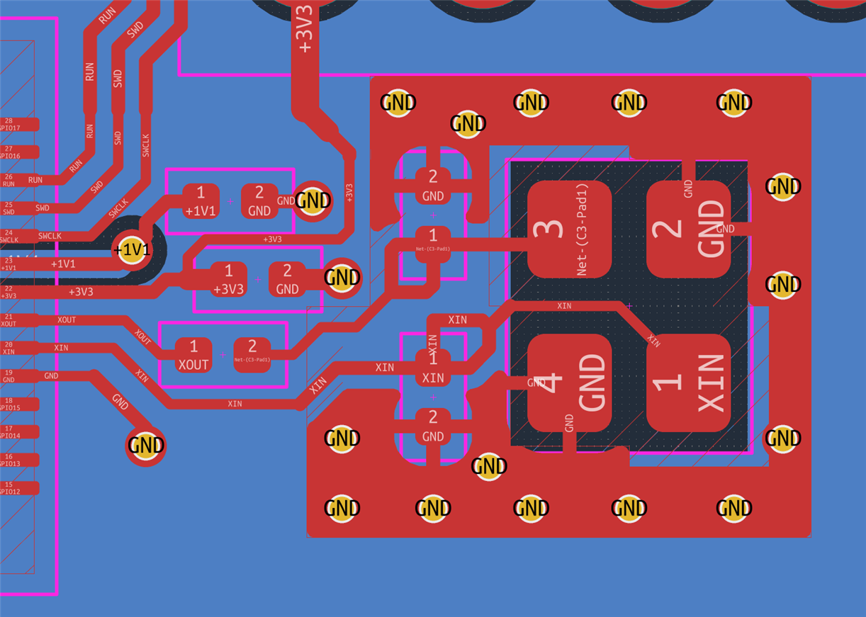

Partly out of curiosity, and partly to test some aspects of a workflow for other projects, I decided to create a custom RP2040 board. In most cases, there’s no need to do this; it may well be more expensive than simply using a ready-made Raspberry Pi Pico module and mounting it on a custom PCB, while saving a considerable amount of effort.
This short blog post describes how I’m approaching the project. It’s very much a work in progress.
The first thing I did was download the RP2040 hardware design guide PDF, and the minimal RP2040 design KiCad zip file from the Raspberry Pi website and extract and open the design with KiCad 10. This is what the minimal schematic looks like (click to enlarge):
The corresponding PCB layout is shown below. My plan is to reuse parts of this design while adapting it to fit the shape and requirements of my own PCB:
By examining the minimal PCB layout, it was possible to see that nearly all traces were on the top layer, with just a few on the underside, leaving the majority of the bottom copper being a ground plane.
Next, I modified the schematic by removing the components I didn’t need and adding the functionality I wanted. For example, I removed the pin headers and the Micro-B USB connector, replacing the latter with a USB-C connector. I also added RS-485 circuitry to one of the UART ports, since the board is intended to function as an RS-485 adapter.
You’ll also notice a 10-pin connector that appears to be underutilised. That’s intentional. I plan to route several unused GPIO pins to that connector in case I need them later. I haven’t assigned specific GPIOs yet; I’ll wait until the connector has been placed on the PCB so that I can choose whichever pins are physically closest. Anything that makes trace routing a little easier is worth considering!
With the schematic updated, I switched to the PCB editor and took a screenshot of the original layout for reference. I then selected the main central portion of the circuitry and moved it onto my new PCB outline.
The result looked promising:
The original design includes a top-layer +3.3 V copper fill zone, and I wanted to preserve part of that arrangement. To do this, I simply created a new fill zone and roughly followed the outline of the original design, almost like connecting the dots.
Once that was done, I moved the new fill zone into its final position. In hindsight, it would have been easier to create the fill zone first and move it together with the rest of the circuitry, but it only took a few moments to fix. The layout was already starting to come together nicely.
Next, I selected the voltage regulator section from the original PCB and moved it into the desired location on the new board. Since I no longer needed any of the remaining elements from the original PCB layout, I deleted them. At this point, the project had effectively become a normal PCB design exercise, with the remaining tasks being component placement and trace routing.
I’ll write a Part 2 (EDIT: Here is part 2: (+) Getting Custom RP2040 Boards Produced and Assembled with KiCad, Part 2! - element14 Community ) once the layout is complete. I suspect it will be an even shorter post, since everything appears to be progressing smoothly so far.
Thanks for reading!
    shabaz 3 months ago +2
    I wonder if the Raspberry Pi people every got one of these PCBs assembled.. they have traces not running through the center of pads. These are lightweight 0402 parts, they will rotate as the solder reflows…

    arvindsa 3 months ago +1
    I came here from your Part 2 of this post. Looking at the PCB Layout of the original PCB, I see a lot of polygon on top layer for the 3.3V Net. Now before I say something more, I have to say that I believe…

    Ah, shabaz  Appreciate your views, you've done a thorough analysis, and I see now,  they did add fence around the crystal. That's not a good move from their end. I think what the designers did is they put in the ultra level of best practices out of force of habit for this simple board. Only the circuit is minimalistic not the board layout Smiley

    shabaz 3 months ago in reply to arvindsa
    Hi,
    I agree with your and geralds conclusion, they are not really needed. There's a couple of comments from RPI regarding needing a couple of capacitors very close to the RP2040 (one for 3.3V decoupling, and the other for 1.1V decoupling(, so a bit of supply polygon there can be useful just to practically get more connections to those capacitors, to reduce the series inductance. I don't think RPI did as good a job on the 1.1V decoupling in that minimal board, so I just now modified it slightly. The orange arrows show the pin and capacitor for 3.3V decoupling, and the green is for 1.1V (previously, there was only one connection to that 1.1V decoupling capacitor on each end, now there are three as you can see.
    Other than that, I too don't like having too much unnecessary power planes on top, but on a 2-layer board (especially larger ones) some copper balancing is needed to prevent the PCB curving, so if there are large empty areas I will either tie them to ground, or supply (depending on what connections are nearby). Some people just fill the entire top side with one big polygon, say at 3.3V or GND, which is valid too, but it does visually get difficult to follow traces when troubleshooting. Another option is to fill it all on top but then insert "no fill" keepout rule polygons in dense areas. They can all be valid options, sometimes it's just personal preference.
    I wasn't happy with the crystal footprint, I just now modified that too, with keepout polygons, so that there is never copper fill too close to it since that will just be stray capacitance. I added a bottom-layer keepout too, although probably unnecessary for 2-layer boards. Plus the via fence is likely unnecessary for crystals, but if it were changed to an oscillator module, then it could be helpful to reduce emission.
    I'll upload these changes to the Github repo, but first I want to make those USB connections in the method that Gerald mentioned. And will also look for an easily-available and low-cost SMD USB-C connector, since it will save a bit of cost during assembly.
    EDIT: also, I will try to find a cheaper crystal, since the one used in the minimal design costs as much as the RP2040 chip.

    arvindsa 3 months ago in reply to geralds
    Yes, heat does increase with increased frequency. I primarily work with STM32 Series and Nordic 52 and never worked with RP MCUs, So i am following this with curiosity. . The QFN Packages come with thermal pads and their datasheets recommend, it be grounded along with vias to wick the heat to other side.  Also another additional recommendation would be the other side of PCB under the thermal pad (connected via) can be kept without solder mask to improve heat transfer away from the system. But other chips have one thing common, the heat dissipation is via ground or an isolated net.
    And again, You are correct in saying that thermals is something to pay attention to, infact thermals is something many beginners overlook especially the thermal reliefs for each pad. I solder the one PCB using hands with MHP-50. It is a 50x50mm soldering plate and The ground planes do help conduct the heat to other areas of PCB and sort of works like a reflow profile. But it does not work when i have large 3V3 polygons which i use for specific reasons (Switching currents etc).
    It would be interesting to learn if RPi Found a way to improve heat dissipation via VDD plane too.
