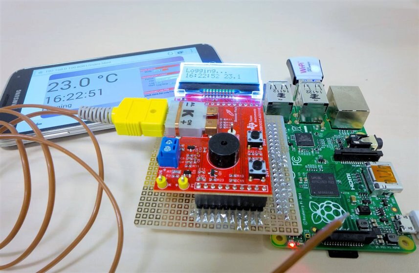

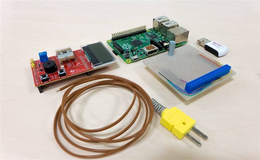

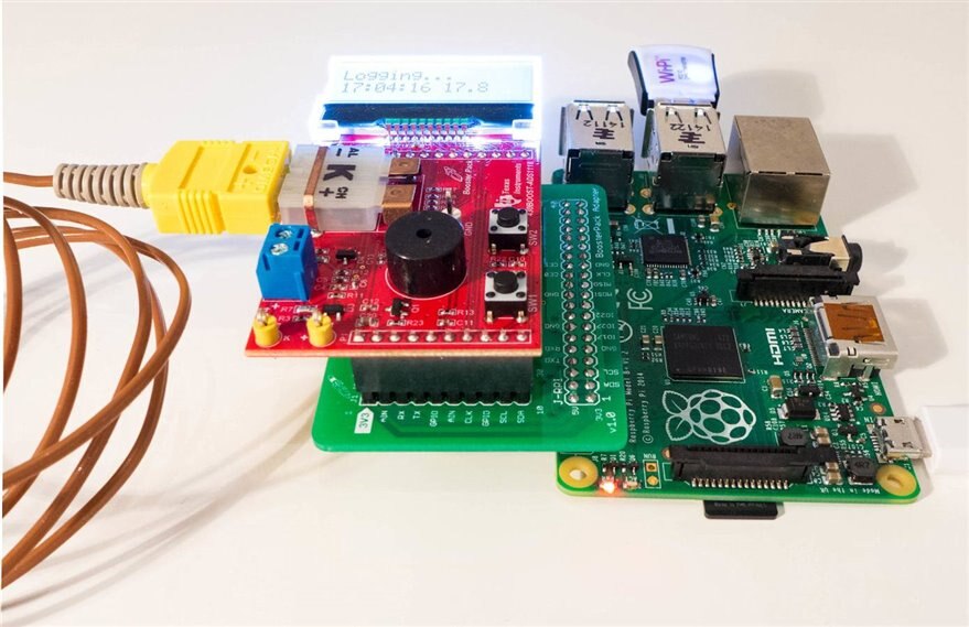

This project shows how to connect up a thermocouple board to a Raspberry Pi (RPI), and use it for temperature measurement and logging with great performance and ultra-low cost. This project is easy – no soldering required unless you want to. This is also a great project to start using the 'DIL (dual-in-line) header'  connector on the RPI if you have not already done so.
Here is a video showing the entire project in action; the brown cable is the temperature probe.

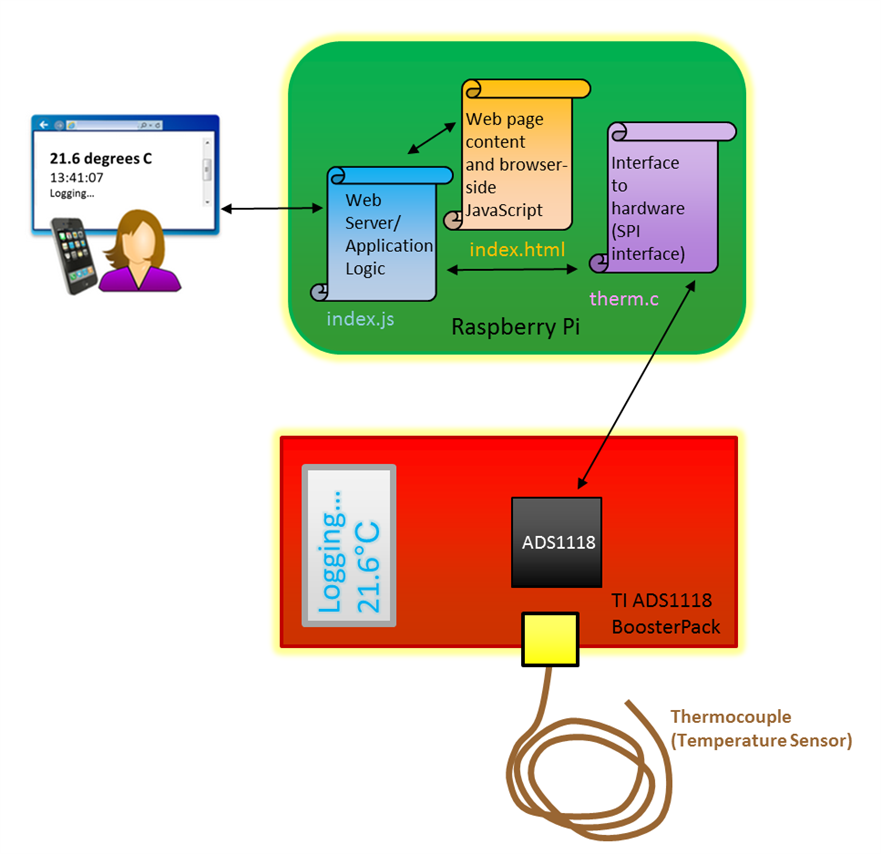

Design Overview
A lot of thermocouple-based hobbyist projects use the MAX31855 integrated circuit and ready-built ‘thermocouple amplifier’ boards are available for connecting to the RPI from several suppliers. This project however uses the far higher-resolution ADS1118 from Texas Instruments. It comes in a surface-mount package but fortunately a ready-built ADS1118 development boardready-built ADS1118 development board is available which contains all circuitry including a LCD display and thermocouple - it is extremely good value for money. If you don’t fancy soldering then it is possible to connect up this board to the Raspberry Pi (or any other computer board – it uses a standards based communicaton method called Serial Peripheral Interface or SPI) using eight jumper wires (male-to-female cables are needed). Alternatively, if you don’t mind a soldering exercise then a small adapter board can be constructed. This was the approach taken here. In summary you can see in the photo below all the bits that are used for this project, including the assembled adapter board.
The entire project can be controlled via a web browser or from the command line.

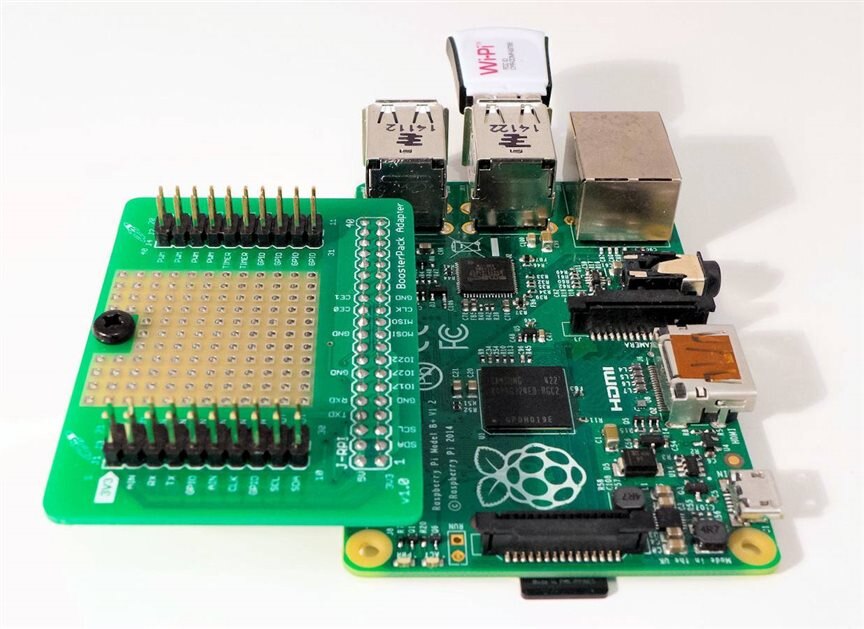

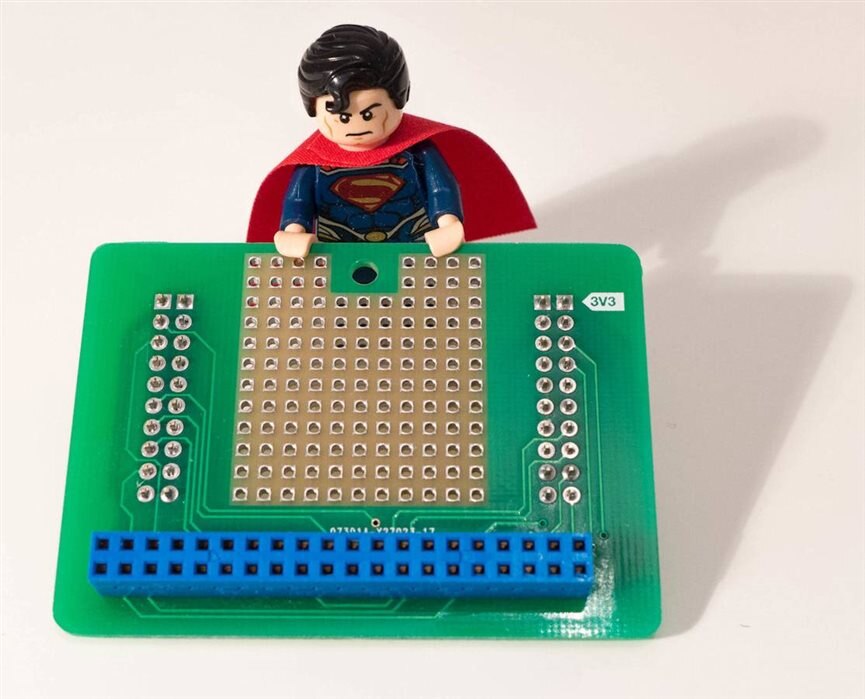

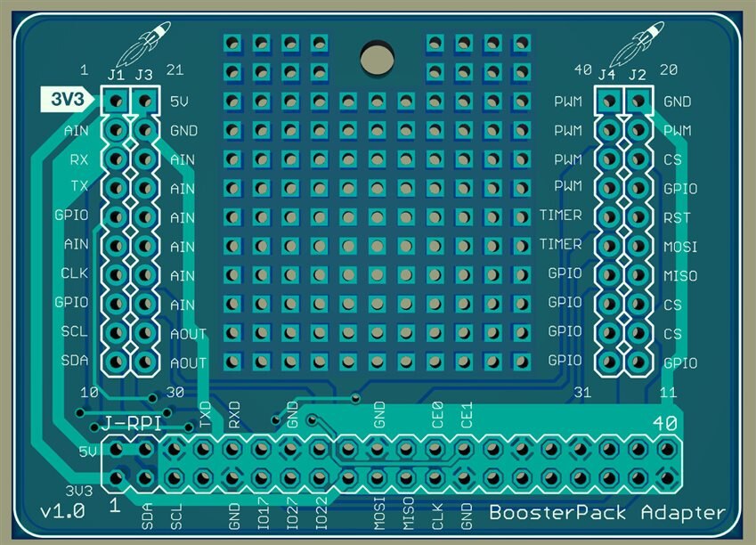

To build the adapter board, the simplest way is to use a circuit board; using EAGLE software I drew up a design for which the files are attached to this post ready to send off to a PCB manufacturer (it costs about $30 for ten boards).

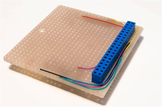

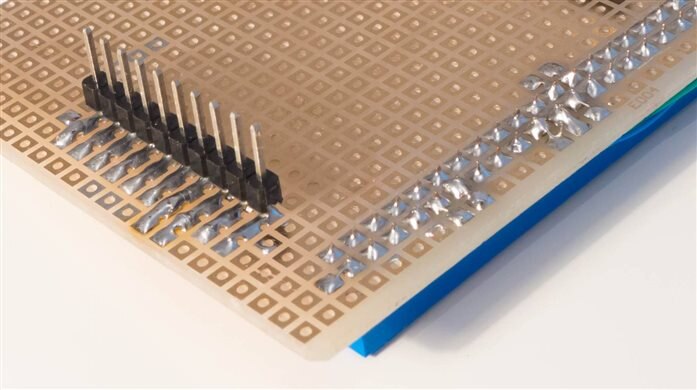

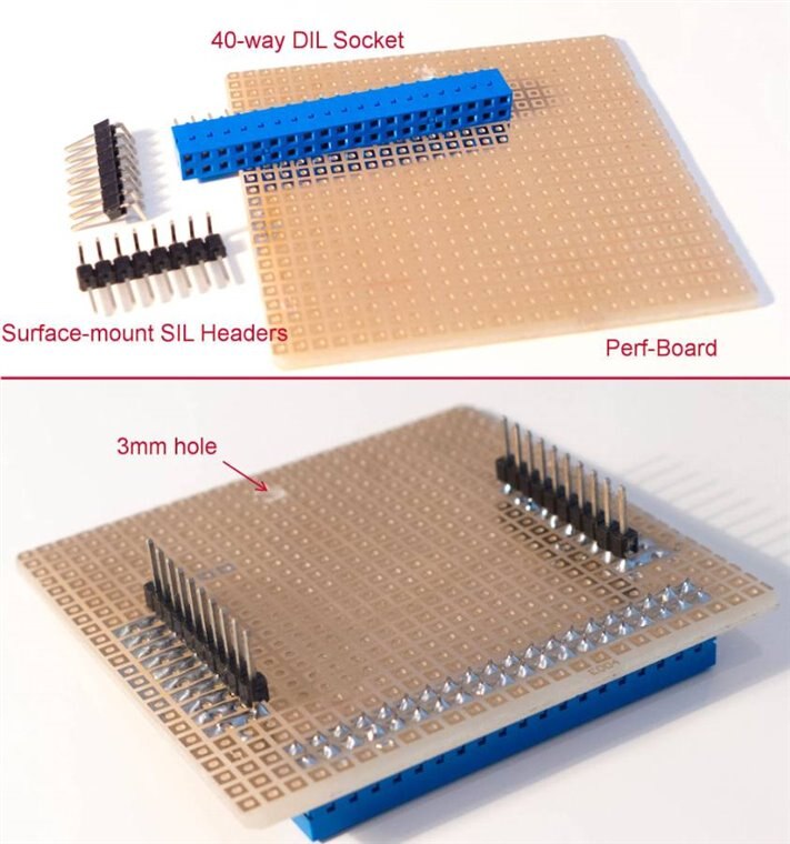

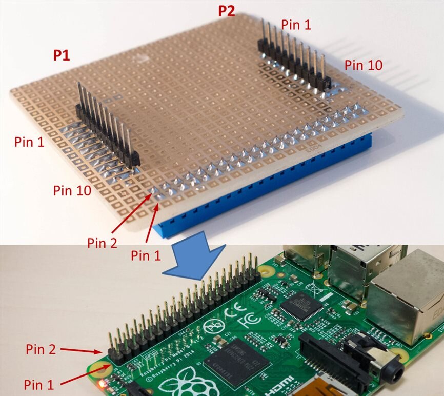

Alternatively, prototyping board can be used; I obtained some perf-boardperf-board (the type with isolated pads, not stripboard) and cut it to size. A 3mm hole was drilled for attaching a support pillar (threaded hex spacer)support pillar (threaded hex spacer). The boards are next to each other, not on top of each other, to minimise temperature change and noise issues, both of which would have an effect on the thermocouple reading.
The next step was to solder a  40-way DIL header socket  40-way DIL header socket.
I wanted the ability to plug in the ADS1118 board onto the pad side of the perf-board, so there is a slight complication here. The solution was to use bent SIL headers. 10-way SIL headers10-way SIL headers are needed (the photo shows 8-way which is what I had at hand) - or use surface mount ones which are similar but with the bent ends alternating on either side. If you are using a circuit board and not perf-board, then straight SIL headersstraight SIL headers are needed.
To get them aligned, plug them into the ADS1118 board, and position it over the perf-board and then tack a few pins with solder. Then the ADS board can be very gently unplugged and the SIL headers can then be soldered properly. Note that at this stage it is quite difficult to unplug without tearing the pads off the board. Hold the bent part of the SIL headers against the board while unplugging the ADS1118 board.
Next, to make the SIL headers very secure, solder each pin to as many pads as possible (each one can be soldered to three pads).
The next step is to wire it up. I used Kynar wireKynar wire which is very thin but any wire will do.
To identify the connections, refer to the pin numbering photo below and the following table:

After testing the software and board functionality, it is possible to use some epoxy resin glue (e.g. Araldite) to make the SIL headers even more secure. A minimal amount was used so that it was possible to still just-about solder onto the pins if needed to in future.

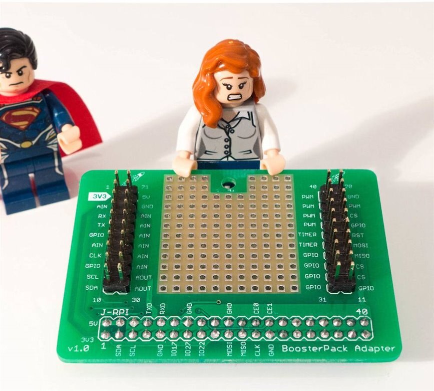

With the PCB approach mentioned earlier, when the PCB arrives, the header pins and receptacle can be soldered, and it is an easy task (takes five minutes) so the PCB is the preferred method especially if you need to make many of them (I intend to make several). I used DIL header pins instead of SIL, but either will work with the PCB layout attached to this post.

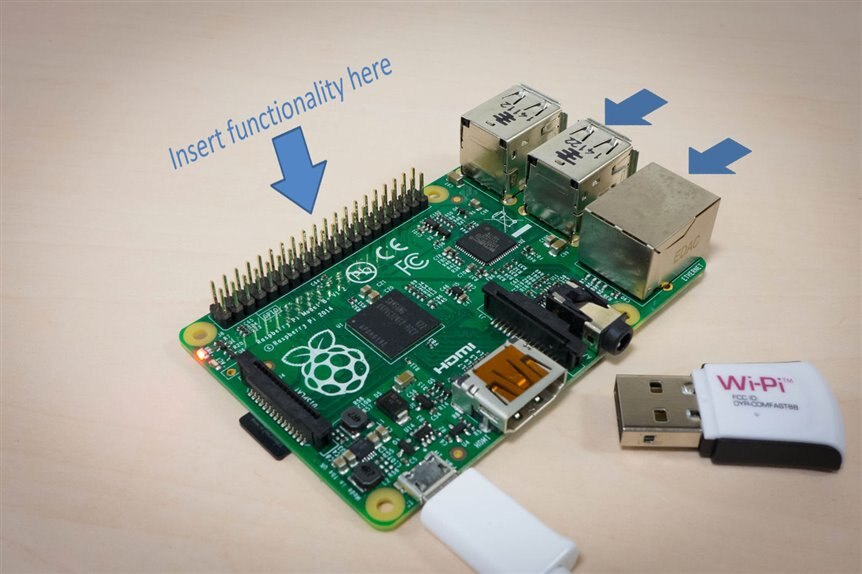

Here it is attached to the RPI:
Underside view:

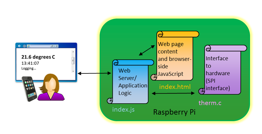

The diagram here shows the entire solution overview. The majority of the code is in three files. The code that interfaces to the ADS1118 board is discussed first, because it is possible to run this code standalone if desired. It is shown in purple in the diagram.

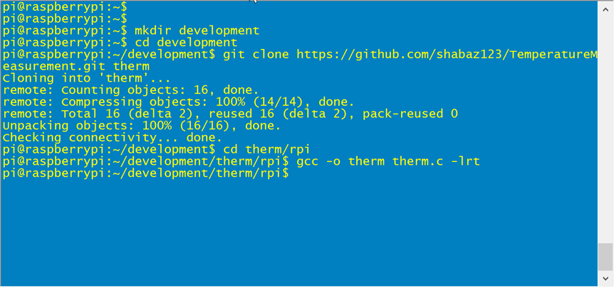

First off, confirm that some features are enabled on the RPI. If the RPI is being used fresh, then after operating system installation, ensure that the ‘Advanced’ menu option is selected and then enable three things: SSH, SPI and I2C - we don't use all these for this project, but they are standards based interfaces that should always be enabled unless you never want to unplug the RPI from a monitor or not make use of the 40-way DIL connector on the RPI. If this was not done after OS install, then type raspi-config in a text window (also known as a command shell) on the RPI and then select ‘Advanced’ in the menu that appears.
Assuming the three features mentioned above are enabled, then create a folder for your work off your home directory (e.g. create a folder called development and then a sub-folder called therm) and copy the source code (stored at github.com) into that sub-folder.
Here is how to do all this:
To compile the code (also shown in the screenshot above) type:
gcc -o therm therm.c -lrt

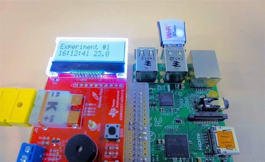

To print some text to the LCD display, type:
./therm msg “Experiment #1”

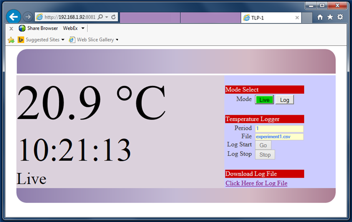

Using a Web Browser
To use web browser capability, a platform called Node.js is run on the RPI. There are plenty of projects on Element 14 using Node.js with the RPI or BeagleBone Black. To avoid repeating, just follow the Node.js and Socket.IO install steps at this location (scroll to the section "Raspberry Pi web server and application software") and follow all the steps listed in that section up to and including the command ‘npm install socket.io’.
The code that will be used to enable web control is shown in blue and orange in the diagram below:
To run the web server/application software, type
node index.js
Now you can navigate using a web browser to http://xx.xx.xx.xx:8081/index.html to see the web page. Click ‘Live’ to see the live view of temperature.
Select a file name and click ‘Log’ to start logging data.

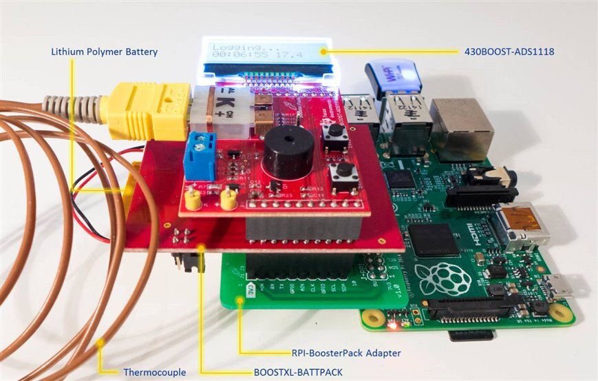

If desired (e.g. outdoor use), the solution can be powered from a Lithium Polymer (LiPo) cell. To do this, a BatteryBoosterPackBatteryBoosterPack is inserted in-between the adapter board that was created, and the thermocouple board. Here is what it looks like:
The Battery BoosterPack comes with the LiPo cell. Note that some slight modifications need to be done to the Battery BoosterPack before it is used for this project, in order to prevent any pins from clashing. See this blog post (scroll to the section titled "Battery Power" and perform the steps in that section).

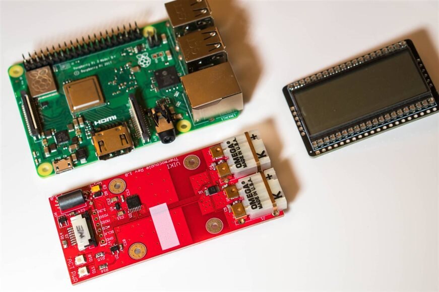

Future Plans: A new version
As of July 2019, a new version is being developed (it is almost complete), that has two thermocouple connectors. The new board will connect to the Pi via jumper wires, it is not a plug-on board. Optionally, the same board will also work with the VIKI project, and in that case the thermocouples will be electrically isolated from the Pi. The display is a separate project. The new version needs to be tested, and then the details will be shared so anyone can make it. For more information about the new version, please see the comments below until the full details are written up in a blog.
Source Code
Code is available on GitHub, click here. The initial version has functionality to display temperature on the LCD display and on the browser dynamically, and also initiate logging (and displaying temperature). It is experimental code, and will need enhancements; currently it is not possible to stop the logging if started, except by going to the command line.
It has some bugs, such as if multiple users connect to the browser, expect occasional erroneous values of 0 degrees C on the display briefly if multiple users connect and the system is not logging (if the system is logging, this issue does not occur). Also it may display 'error' briefly when connecting. It continues to function.
There are no known issues with the actual measurements and the logging functionality, however if you are planning to run a very long (multiple hours) experiment, it would be good to have a dry run first, to confirm the system functions for an extended time - I only ran the system for an hour or two at a time. Also, you may wish to log less frequently in that case (currently it logs every second).

    The new version is almost complete.. It still needs to be tested (and code still needs to be developed too, it will be based on the existing code, but tested with Pi 3 and Pi 4).
    With this new version, there are two thermocouple connectors built-in. The board no longer plugs directly on the Pi, but is attached using a few jumper wires. The display is not part of the board, the display is a separate project (or use a 16x2 display etc.).
    The other advantage of this new version is that it can be used with the VIKI project too, by removing the jumpers and replacing with a flat flex cable. With the VIKI project there is the extra advantage that the thermocouples are isolated from the Pi, and there is a built-in display there (16x2 characters).
    Once it is confirmed it all works (might be a few weeks, I need to write the code), I'll publish the details.

  • lornamca
    lornamca over 8 years ago in reply to shabaz
    Brilliant - thank you Shabaz, very helpful image
