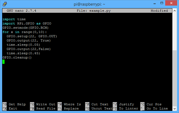

To enter the script I'm going to need a text editor that I can run without the desktop. It seems that GNU Nano
is part of the distribution, so I'll start with that. For it to work with PuTTY, I found that local editing
needed to be turned off.
Here's the Python code I'm using, as seen in the Nano editor's text-terminal-style 'window', framed in PuTTY's
Windows GUI-style window. The code is one of Shabaz's examples.

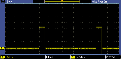

If I give it to the Python interpreter to run and look at the IO pin, it does this on the 'scope
Success!
So, I now have the means to control I/O lines under the control of a Python script and that probably gives me
enough to get me going and produce the first simple piece of art (which I've got to come up with by the end of next
week to stay on schedule). Next blog will be the first proper challenge one and will be in the Picasso Challenge

    In recent times, another Python API has become available, called "gpiozero".
    I saw the gpiozero stuff on the Raspberry Pi website but got the impression that it wasn't available in the Lite version of Rasbian (I might not have interpreted that correctly), so I thought I'd try your code and just see what happened. I'm much happier with it like this - I've done a lot more assembler programming in my time than anything high level, so this level of control feels quite natural (that's the reason I'm uncomfortable, generally, with a language like Python).
