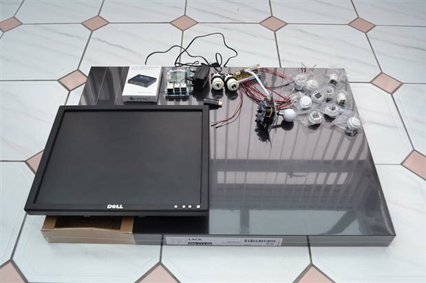

Let's begin with an overview of the parts you'll need:
  • The Cabinet: IKEA Lack coffee table.
  • The Brains: Raspberry Pi
  • The Controls: Arduino Leonardo
  • The Joystick: A classic, four-way ball-top joystick.
  • The Buttons: From CPC  - From MCM
  • The Display: An old 17" LCD monitor (4:3 ratio is better given the square shape of the table).
  • The Sound: This pair of USB-powered computer speakers.
  • The Power: A Raspberry Pi 2.5A USB power supply, and a mains extension.
  • The Stuff: Cables, connectors, screws.

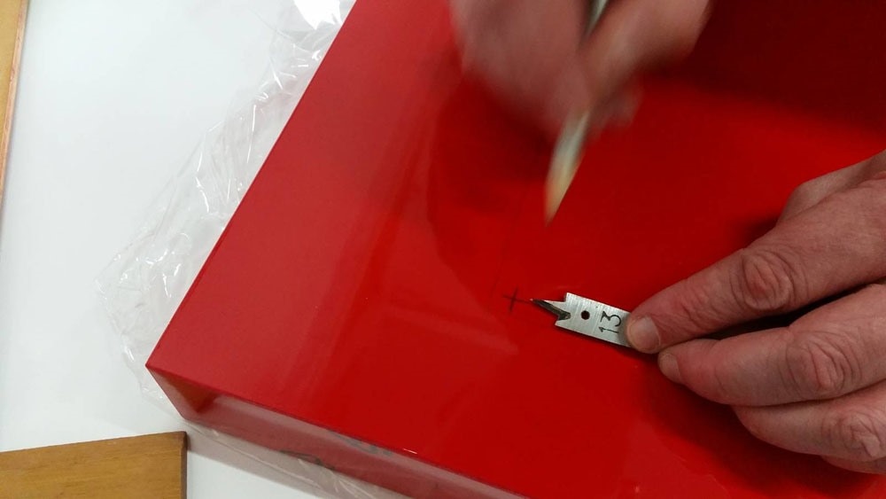

Mark where you want to mount your joystick and buttons -- we went with four buttons -- and drill 28mm holes for each one. This is the standard size for arcade buttons, and also gives the joystick plenty of room to move without the hole being visible around the round, flat cover that comes with the joystick.
But we didn't want any fixings visible on the PIK3A table top, which meant we couldn't use the mounting holes in the joystick's plate. Instead, we removed the mounting plate and used the screws that attach it to the body of the joystick (where the microswitches are) to fix the joystick in place. They're a little bit short, but when you countersink the holes in the table top, they'll still reach and grab hold of the thread solidly.
You'll need to remove the mounting plate's screws and the ball top, and then offer the joystick up from underneath the table. It's a little tricky, as the plate will be loose when you're inserting the joystick into the table, but it's not too hard. When it's in place, replace the mounting plate's screws when passing them through the table top, put the round cover over the stick, put the ball top back on, and you've fixed the joystick in place without any visible screws.
The buttons are a simple matter -- drill the 28mm hole, and put the nut on the back of the button! We went with a diamond arrangement for the buttons, plus a start button and coin button on the side of the table top.

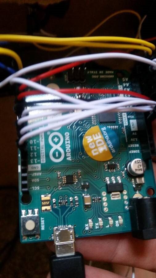

Arcade controls are actually very simple. Even the joysticks are effectively just normally open push buttons (one for each of the four directions). The thing is, computers like the Raspberry Pi don't generally accept such simple buttons as a controller! So we've opted for an Arduino Leonardo as a way to interface the arcade controls with the Raspberry Pi (moreover, the video game emulators the Pi will be running), as it can be set to identify itself to the computer/Raspberry Pi as a standard keyboard.
So each button is connected into one of the Leonardo's inputs, which translates them into keyboard key presses. A ground wire loops around the other side of each microswitch. Because we love the old coin-ops, we set ours up using the standard keyboard controls for MAME. You don't have to do this, but it'll save you a job if you do it this way.

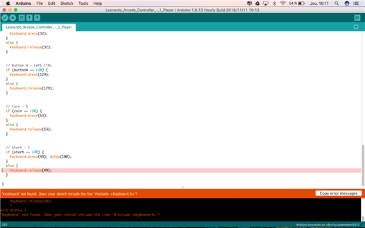

Download and install the Arduino IDE, if you haven't already, and plug in your Leonardo to your computer via a USB cable. Below is the code we hammered together that translates the joystick and buttons into key presses (using the MAME standards, as previously mentioned). But coders we ain't, so if you can improve on this sketch, please post it in the comments.
Before that, here's what to do if you've never played with Arduino before (skip ahead if you know how to upload the sketch to your Leonardo).
    • A "sketch" is a program that your Leonardo will run after it's been uploaded. You can copy and paste the code below into the Arduino IDE window, or download the attached sketch file and open it using the IDE window. It's the same code, but take your pick of how to get onto the Arduino.
    • Take a read through, and you'll see how each input relates to a specific keyboard key press. You can make any desired changes here before uploading to the Leonardo.
    • Click the "Tools" menu and select "Arduino Leonardo" from the "Board" option.
    • Click "Tools" again, and select your Leonardo from the list in the "Ports" option. It's now ready for uploading your sketch.
    • Click the "Upload" button (a circular button with a right-facing arrow in it) to upload the sketch, and the Leonardo is ready to rock.

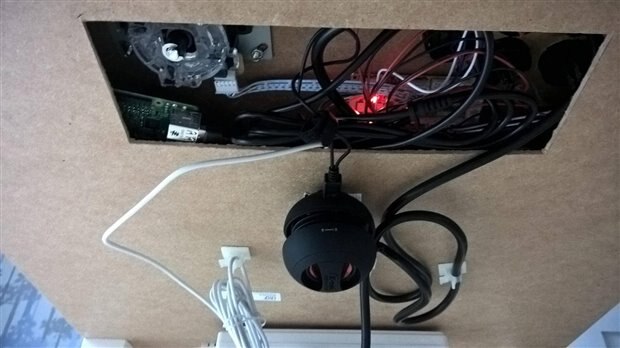

Power
There wasn't really much room left to embed a mains extension inside the table. We cut a connector into the bottom, and wired the extension lead into that. This way we can add a longer power cable if required, or even use one for different regions should the PIK3A table find itself going abroad.
We've powered the speakers and Pi separately, just to spread the load out a bit, but to be honest the Pi3 could handle the speakers from its USB ports. The choice is yours, here.
The monitor, Pi3 and speakers are all connected into the mains extension, powering everything up while hiding the connections beneath the table.
{gallery:autoplay=false} Powering all the Parts
Mark a square in the back corner underneath the table and cut a hole for the power connector. The mains extension is going to connect to the rear of this IEC connector.
Remove the plug from the back of the mains extensions, feed the cable through the inside of the table and bring it out of the hole for the IEC connector. You can now solder the wires to the reverse of the IEC connector, and fit it in place.
It doesn't hurt to screw the mains extension to the bottom of the table, too. In my experience, they tend to fall off the eyelet holes if there's a light breeze, so this one is screwed in place from inside.
You can plug the monitor and a couple of USB adapters into this, to power the screen, Raspberry Pi and speakers, while only requiring one power cable.

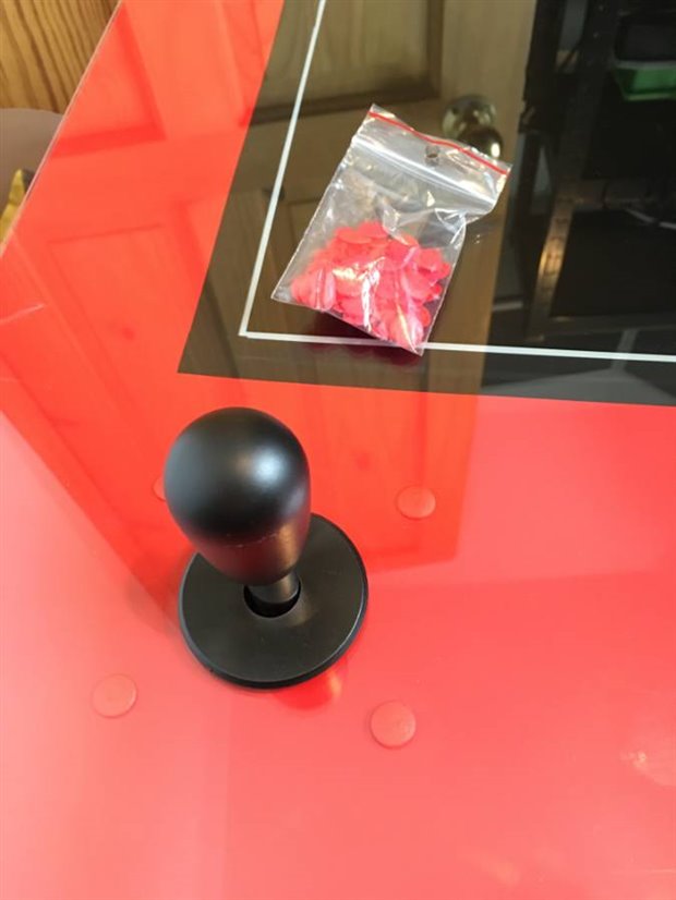

The monitor is a bit vulnerable here, so we decided to get a piece of 3mm acrylic cut to the same size as the table top (550mm by 550mm). It's just screwed into the table top in each corner, and the screws hidden behind screw caps. It's a cheap way to keep things protected.
I also added a panel mount USB port next to the access panel underneath, just in case I ever need to plug a USB keyboard (or other peripheral -- it could be a joypad if you wanted) into the Pi3.
{gallery:autoplay=false} Finishing Touches
An external USB port that goes into the Pi. This is a good one, as it also has a dust cap, since this probably isn't going to get a lot of use.
If you decide to put an acrylic or polycarbonate sheet on top to protect the monitor, remember to put it in place before you insert the buttons, as they'll need to pass through the sheet.
Here we've screwed it in place in each corner, and covered the screw heads with caps.

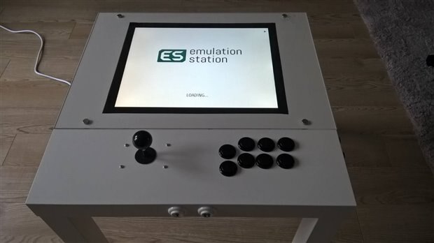

Then it's just a case of screwing the legs to the table top, and installing RetroPie on the SD card. There's one additional step you might have to perform for the time being, to get RetroPie running in the Raspberry Pi 3. The developers will undoubtedly fix things very soon, but for the moment we had to copy over the "*.elf" files (that'd be imagestart.elf, start_cd.elf, start_db.elf and start_x.elf) from the "Boot" partition of an SD card that had the official, Raspberry Pi NOOBs image.
Not a complex or particularly onerous task, but a necessary one for the time being. This should get RetroPie booted up and running beautifully on your awesome new PIK3A retro gaming table. I'm sure it won't be long at all before this step becomes unnecessary, of course -- likely by the time you've built your cab.
UPDATE: The RetroPie guys have already released an updated image, so you don't have to jump through any hoops to get RetroPie working on your Raspberry Pi 3! Great work, guys!
http://blog.petrockblock.com/2016/03/02/retropie-3-6-is-released/
As you can see, this is a pretty fascinating interpretation of the classic gaming system, so we'd be particularly interested in seeing how you might do the same, as much as copy our build part for part. Post your own retro gaming projects right here in the Raspberry Pi Projects sections, and casually blow our minds!

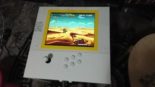

  • kravex
    kravex over 10 years ago
    Finished at last!
    I never got the HDMI splitter to work correctly, it seemed to only want to work if both the TV and monitor were on and plugged in, I even locked down the monitor res in config.txt but it didn't help. The screen is attached with magnets glued on top and under the wood so it can be removed if it causes any glare but is sturdily held in place.
    I slipped a bit with the drill so the bottom left 2 buttons aren't as much to the left as I'd like but even with the table costing only £5, the 120 mile round trip to pick up another one means it'll do!
    I used a 17" monitor (the first 2 ordered were the wrong model when they turned up, hence the delay) so space was getting a little tight for speakers so I used a X-Mini II on the bottom which is probably better quality than the cheap speakers I was going to pull apart for it.
    Next with opposite colours!
