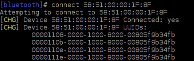

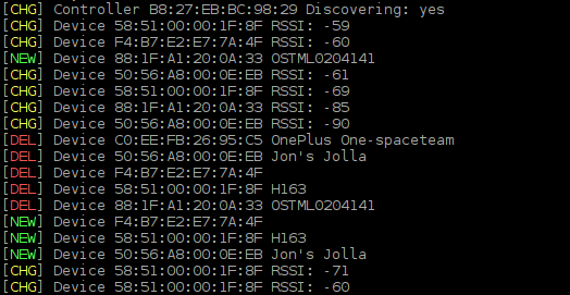

Now we are in bluetoothctl we can run the commands, first lets make sure that bluetooth is on, running and discovering devices:
With the commands 'power on', 'agent on' and 'scan on'. Though we likely only need 'power on' and 'scan on'.
Devices! and while the software is running we will see devices appear, change, delete, etc. We can then connect to a device using its MAC address. Basically, we are talking to the devices directly at the hardware layer, usually on your typical WiFi or Ethernet network this is done transparently to you and we only work with IP addresses. However with Bluetooth at this point, no.
We can also then pair and trust the device and do all the fun features of Bluetooth, provided these are successful.

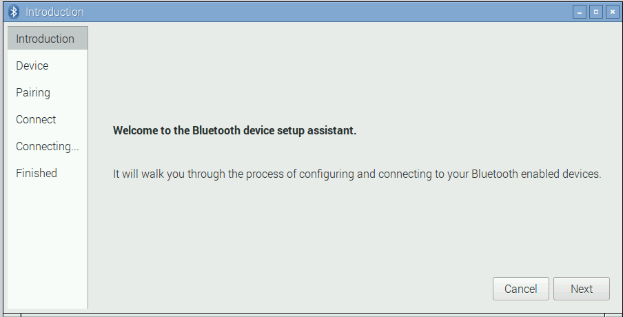

GUI
Some consider the blueman package and software to be unstable, though the sources saying so are a bit dated by now and it may be somewhat more stable.

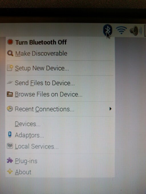

When you have the blueman package installed, you should have a nice Bluetooth icon in your system tray. If you left-click with a mouse connected to your Raspberry Pi you should get a menu with all of the, hopefully, self explanatory options for you to play with, which for some reason I could not capture with scrot/imagemagick, so you get a nice photograph:

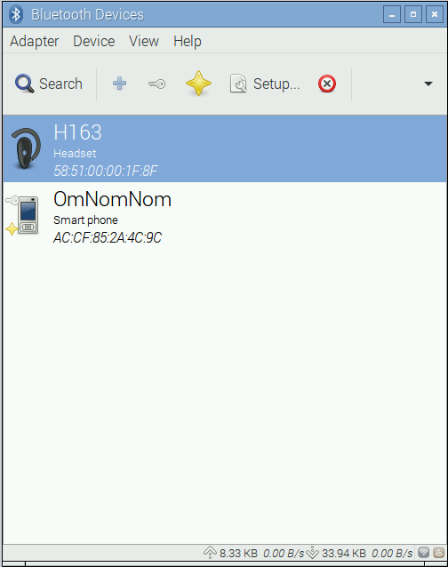

Yum, pixelated (it was an old Dell monitor). If we want to scan for devices, similarly to using the 'scan' command for bluetoothctl then we select 'Devices' on the menu:
And from here we can see what is available in the vicinity, you may be surprised at suddenly finding your neighbours smart television or phone, you will find out how thin your walls really are. It can be more fun in the office at work.

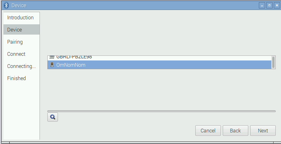

However, let us select "setup a new device":
{gallery} Add New Device
Add New Devices: Introduction
Add New Device: Choose the Device to Connect to

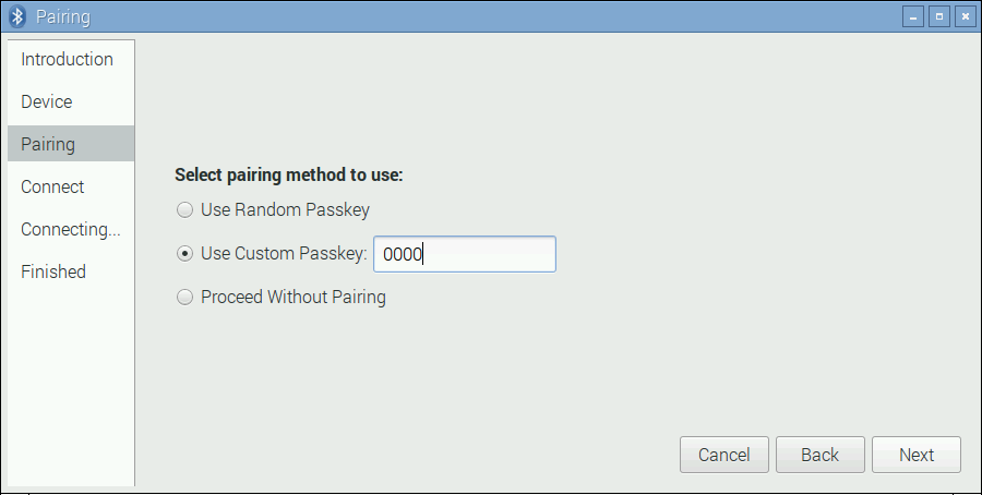

Add New Device: Choose a pairing code
However, what I discovered is that the passkey method is practically deprecated or ignored, it may be applicable for older Bluetooth software or devices, but these days you will get a prompt appear (and for myself, then hide) on Raspbian, next to the icon for blueman, there will be a message, and in this message it will display a message like:
This device wants to pair with this machine, with this code xxxxxxxx, do you want to permit or deny?
This likely happens with new devices such as smart phones and televisions, as a security measure that you are physically holding or looking at the device in question. Of course you then 'permit' on either the device or Raspbian and the two will be paired. Allowing you to then setup drivers for your Bluetooth device functionality, to use it as a modem, in the case of a phone, share its internet access or simply send files to and from it. Potentially, you can even use it as an audio device!
Attaching to devices such as headsets tends to be easier, and usually does not use a pairing code. A standard is usually four zeroes (0000) with most consumer devices.
