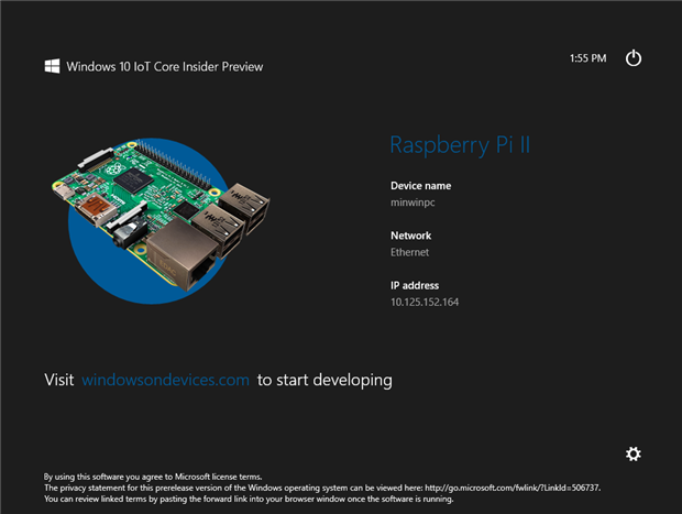

Windows 10 IoT Core on the Raspberry Pi 2
Now out of Developer Preview!image
Steve Teixeira of Microsoft gives this statement:
"We’re embracing the simple principle of helping Makers and device builders do more by bringing our world-class development tools, the power of the Universal Windows Platform, direct access to hardware capabilities, and the ability to remotely debug, update, and manage the software running on Raspberry Pi 2 devices.
This Insider Preview release of Windows 10 IoT Core is our conversation-starter. Our goal is to give Makers the opportunity to play with the software bits early and to listen to the feedback on what’s working well and what we can do better. You may notice some missing drivers or rough edges; we look forward to receiving your feedback to help us prioritize our development work.
We will be incorporating the feedback we receive into regular software updates along with additional drivers, bug fixes and new features. Those looking for a commercial-quality release should wait for general availability this summer."
Called it!
I previously blogged that Windows 10 on the Raspberry Pi 2 will not have a desktop and instead, it is an integrated, Internet of Things development system that is compatible with Microsoft Windows 10. In the Microsoft Build 2015 keynote they presented the integration of the HoloLens with a robot controlled by a Raspberry Pi 2 which is running Windows 10.
Source: https://www.raspberrypi.org/windows-10-for-iot/

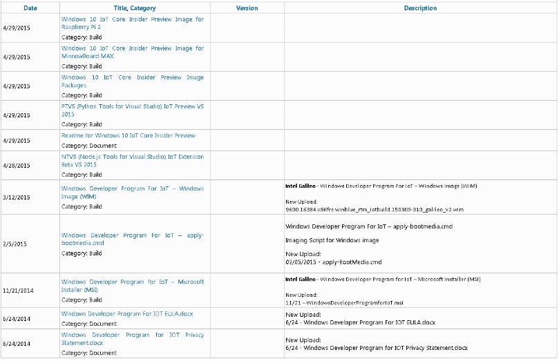

Is this the Embedded Pre-Release Program?
Yes, it was at least. you had to sign up to the "Windows Embedded Pre-Release Program" on 'Microsoft Connect'. While there was also the 'Windows On Devices' site, and now there's the 'Windows IoT' site, they did loop you around blogs and links. When you've went to the Pre-Release Program downloads area you saw this:
So once you've downloaded your Windows 10 IoT Core Insider Preview Image for Raspberry Pi 2 you're going to want to get it onto the Raspberry Pi 2. The zip file you've downloaded contains the following files:
This is a bit of a miss-direction. At this stage we're not entirely interested in using WindowsDeveloperProgramForIoT, for that you'll have to be running Windows 10. In fact, to do anything with this device, you're going to need:
